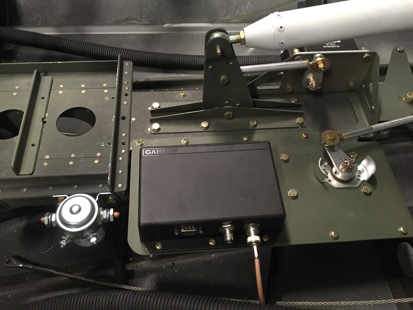

That's why we decided to fab our own mount... it isn't done so I haven't posted much info on our blog about it yet (I haven't posted much of *anything* lately :(), but basically you start with Van's ADAHRS mounting tray (the one that installs next to the elevator bellcrank), add some reinforcement, and fabricate a boomerang-style bellcrank with similar hinge geometry to the cable attachment points on the rudder itself, then connect the servo to the boomerang with a pushrod, and the boomerang to the existing rudder cables with another set of cables.
For peace of mind on an OE design though, I can't argue against buying the Garmin piece either. Just depends on what you're comfortable with tackling!
EDIT: You can barely see what I'm talking about to the far right of this image:
