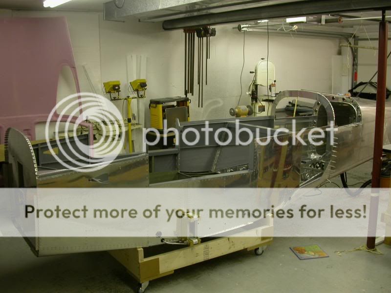

Berk, welcome to the adventure. I agree that when fitting canopy and doors, you want it lower to the ground. The canopy gets put on and taken off about a thousand times, can't really picture doing this with a step ladder! The construction sequence laid out in the plans works well. You will want to build a dolly on wheels, as low to the ground as possible.
Looking at these old photos makes me miss the construction phase.......enjoy.

Thanks guys that is exactly what I was wondering....if the landing gear made the plane to high to comfortably work on. I have already lowered it once when I started working on the baggage doors after getting tail cone on.
I like the dolly Andy! My dolly consist of an armless office chairs on each side of the fuse that have those hydrolic levers - lowered all they way down. My quick fix when I wanted it lower and to be able to roll.
