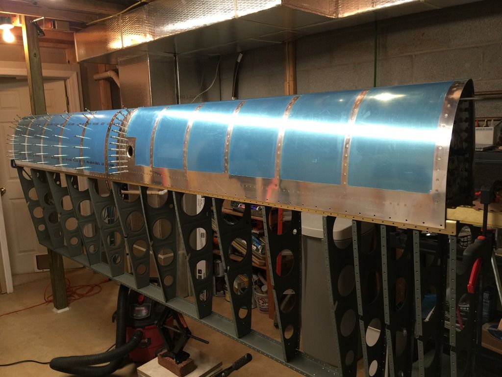

Wing progress. After 4 weeks of work it was nice to see some visible progress.
http://
http://

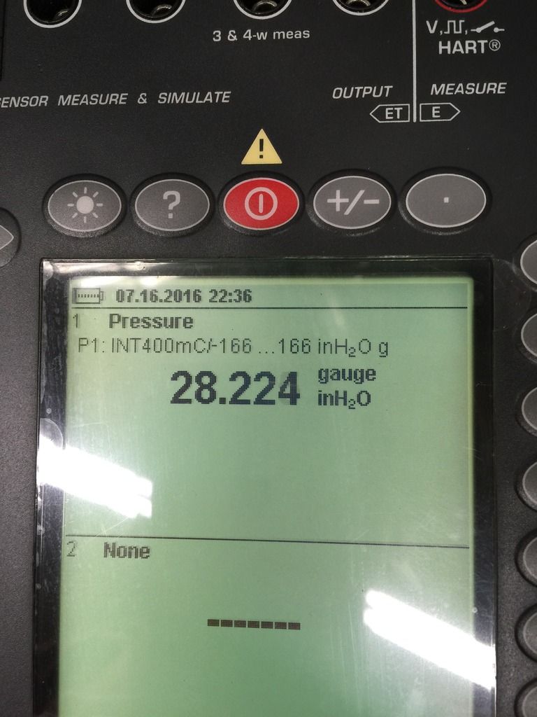

gsxphil 07-18-2016 06:25 AM
More progress on wings.
Left tank is complete and no leaks thankfully. Next is to rivet leading edge together and then on to the skins.
http://
http://
http://
http://
gsxphil 08-17-2016 10:07 AM
Wing and aileron progress.
Top skin riveted to left wing. My RV friends Dave and Paul came over and helped me on top skins. In 2 1/2 hours we did the whole top. Unbelievable, i couldnt believe we did them that fast. Paul is a four time RV builder and Dave is nearing completion of his RV 7. I had alot of experienced help.
Started ailerons, intend to finish ailerons and flaps and then begin the right wing. Hope to order fuse kit in Nov or Dec
http://
http://

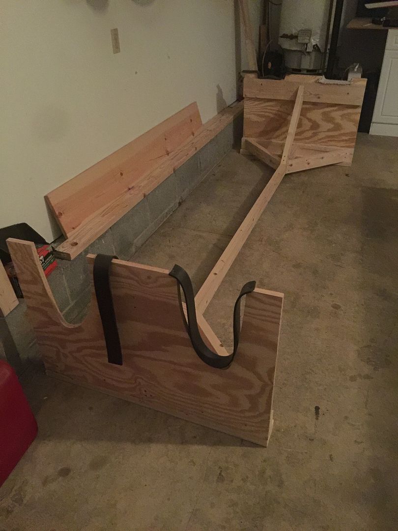

gsxphil 09-27-2016 06:04 PM
Ailerons completed.
On to Flaps next and then plan on starting right wing. Ive got main spar ready to rivet ribs. Glad i have alot of the countersinking and nutplates done already.
Just completed my wind cradle tonight. Hope to order fuselage by Nov.
