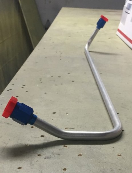

I just wanted to make a quick comment on this thread after speaking with Tom earlier.
First off, it is true that flex lines are heavier than rigid tubing. The question is how much. I will use an RV-12 crossover hose kit that was jointly developed by Aircraft Specialty and TS Flightlines. There are a total of 6 braided stainless lines as well as all the AN fittings to change over to our system.
This hose kit weighs 1lb 5 oz complete including AN fittings. It does not take into account the fittings/plastic tubing that is not utilized if you install this kit. So, my guess is that it is probably about a 1lb weight gain or perhaps slightly over versus the stock components. This is just for illustrative purposes. The advantages are that you end up with brake hoses that will last for the life of the aircraft, have a 10 year guarantee on them, and require no fabrication.
The disadvantage is that it is an aftermarket component that has a cost associated with it, and there is a small net weight gain.
Another topic that has been brought up in the past is the issue of life limits of flex hoses. The hoses that Tom and I use are only the highest quality teflon/conductive teflon hoses. These hoses have no defined service life and as long as they are not abused should be flying on your aircraft long after you are no longer flying it. In addition, we utilize stainless fittings throughout, rather than lesser quality fittings that may be a different material with a stainless coating over the top. This ensures that both the fittings and the hose are matched from the standpoint of a long service life.
Regarding the rigid tube discussion. Rigid tubes are intriguing because fabrication techniques and enjoyment vary from builder to builder. Some people thoroughly enjoy it while others absolutely hate the rigid tube portion of aircraft. That's one of the reasons we decided to begin fabrication of rigid tubes for select aircraft. Tom and I have a computerized tubing bender as well as a CNC lathe which has allowed us to start bringing new products to market. And, we are able to utilize 5052, 6061 and stainless tubing, depending on the application. These have better properties than 3003 from the standpoint of strength. The other day I took one of our 5052 thin wall rigid tubes to about 4,000 psi for the fun of it and held it there for a few minutes. Below is an example of an Rv-14 valve to wing root hose that is pre bent, flared and ready to drop in.
In addition, we can utilize the cnc lathe and bender to build custom rigid/flex assemblies where it is the best option. An example is this picture which shows a custom assembly with a rigid section at the andair valve that transitions to a flex hose to go out to the wing root.
http://aircraftspecialty.com/wpimage...c9fe_05_06.jpg
By having the capability to do rigid and flex hosing, Tom and I are able to offer solutions for those builders who really do not enjoy the fabrication of these lines and would like to focus their energy on other things.
With that said...everything we do can be done ala carte, to allow our customers the choice of fabricating what they enjoy, and allowing us to assist in the rest.
