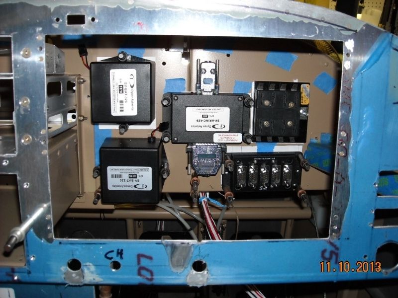

Taildrgr 01-02-2016 08:10 AM
I think you were asking about the sub panel behind the main panel, but if not, please disregard.
I put everything except the VPX and the ground tabs on the sub panel. The ground tabs are on the inner firewall.
For my tipup I had to make sure I marked the inner edge of the tipup frame on the sub panel. That's what most of the blue tape is for.
I made white paper cutouts of each piece and taped them to the sub panel and then drilled the units in place. You can see some of the white and the tape.
You have to make sure to allow space for the connector plugs and attachment flanges. Some are quite large.
I removed the support ribs and used the radio tray as a replacement sub panel support.
