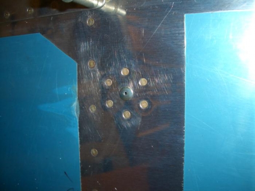

Back in 2007 I mounted mine on the exterior of the skin because of some reported issues and after seeing them mounted in a similar manner on a business jet. In this configuration, they have worked great! (When I had the plane painted, I had them leave the entire fitting unpainted.)
(Click to enlarge)
Brantel 12-23-2015 07:23 AM
I used the original SafeAir static ports mounted inside. Had issues and ended up grinding them completely flush, drilling em out and gluing in the body of one of Van's pop rivets. Problem solved.

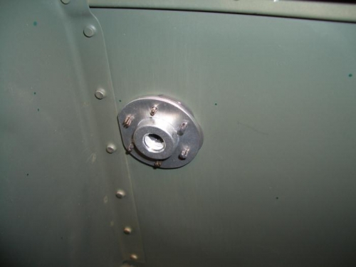

WingsOnWheels 01-07-2016 12:35 PM
My solution was to buy two extra fuel tank drain flanges from Vans (can't recall the P/N right now). I pro-sealed and riveted those to the inside of the skin and installed the pop-rivet as usual with a little pro-seal under the head. Now I have a nice 1/8" NPT fitting on the inside and the default pop-rivet on the outside. Seems like the best of both worlds to me. if I were to do it again, I would probably skip the rivets and just bond the flange in place.
Lynnb 01-07-2016 03:28 PM
Colin,
That looks great. I think I've about decided to do something similier and grind the safeair ports flat, drill them for the pop rivet and just proseal them to the skim and insert the rivet from the outside for the profile.
Lynn

aerhed 01-07-2016 05:03 PM
Colin, I did similar but the flange idea is great.
