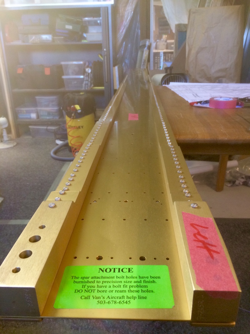

#50
Day one of wing construction!
It has been a while since I worked on anything. I have been at a halt since sometime in October. The empennage was done besides some fiberglass work and after my last application that didn?t dry due to low temperatures I quit working with fiberglass. After getting my used wing kit into my shop I spend about 4 hours inventorying everything and labelling the hardware containers. Boy that took for ever! I had some other things to do with school work and wasn?t able or didn?t allow myself to start build anything because I knew it would only distract me. However last week I decided to start working on the flaps. The plans say it in the manual ?it is the easiest control surface? I figured due to space issues in my shop starting here would be a good idea. I read some build logs and noticed most guys only take like 10 -15 hours to finish the flaps. I must be really slow because I think it will take me way longer. I already spend about 10 hours and I have only finished all the drilling and fabricating all the parts required. But let?s start at the beginning. I looked ad DWG 14A and got out all required parts. I deburred all the parts before assembly to make sure I won?t cut myself. Next step I fabricated the FL-708. 4 of these are required. I marked the one whole with an ?x? figuring the second whole doesn?t need to be marked as long as I have the center line. After putting togeter the skeleton of the left and the right flap I spend about 20 minutes looking for the orientation of the right flap (not shown on the plans). Specifically the the FL-705 ribs? But it was very clearly on the drawing. I just didn?t see it right away. After clecoing the bottom skin I drilled the most aft whole using the skin as a drill guide. After that I drilled the whole into the ribs from the aft side with a shim made from the trim bundle. I had to pay attention while drilling this to stay within edge distance. It helped me to clamp everything down while drilling. The plans call for a number 30# whole in this place so I drilled the whole again with a number #30 After that I drilled all the rest of the wholes of the bottom skin and the skeleton. After fabricating the FL-706B I attached it to the FL-704 end rib. One whole, the one shown in this picture is already pre punched. With that I lined it up and drilled the rest of the wholes. Here all wholes drilled. Drilling the top row of wholes that goes through the end rib, spar and the FL-706A was a bit tricky because it was hard to aligning the wholes and clamping everything down and drilling the wholes, but I got it done. |

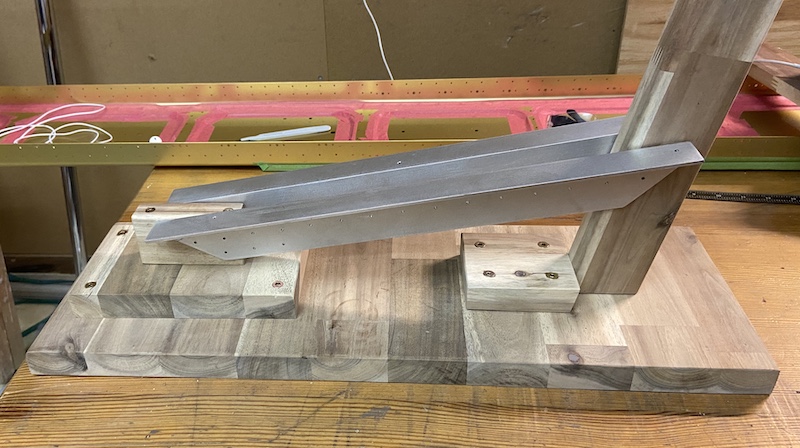

#51

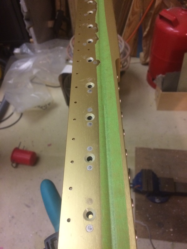

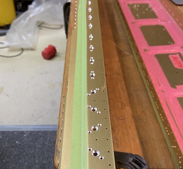

Now that the FL-706B wholes are drilled I enlarged the one originaly prepunched whole to ? in.
Now that the whole is big enough I used a bolt to secure the platenut and aligned it to my liking. Then drilled the 2 rivet wholes with a #40 drill bit. I cut the angle pretty conservatively so they didn?t match 100%. I clecoed it to the FL-706B to the FL-706A and sanded them down until they were flush and nice looking. Edge distance wasn?t a problem with these parts. All that was left to do was to attach the top skin and make sure everything is straight. It is. Not sure what I would have done if it wasn?t. So I went ahed and final drilled all the remaining wholes. Disassembled everything. That was it for now. Next step is to deburr all the wholes and dimple as required. Then prime?. Urg I haven?t primed anything in over half a year! |

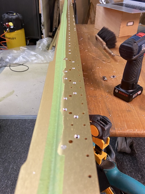

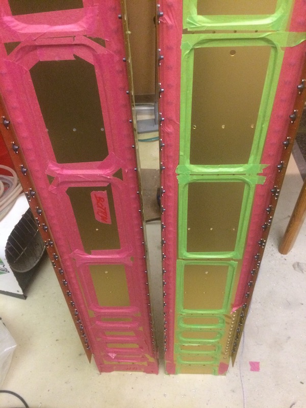

Here we go!
I finally had some time to do a lot of deburring after final drilling al the wholes on both flaps. Bah. Deburring sucks! I totally forgot how time consuming and tedious it is. Anyway, once that was done I had to find a day with good weather and relativlely dry weather for my first priming sessions in a very long time. First I had to get the shop ready and do all the "safety" things related to priming. New filters and such. I also got some new gloves specially for the use with aceton as I wipe the parts with aceton I noticed that I go through gloves pretty quickly even the thicker ones that are not nitril. The chart said they will take 120 min of aceton. I felt the cold through them after 1 minute so I am not sure if that is just the chemical nature of aceton vaporizing making my hands cold. If any of you want to chime in I would welcome it. Ok back to the flaps. I was running low on light and my priming session didnt go as smooth as the last one I remember. I had the fan ope to wide and used a lot of paint in the beginning. So I ran out and had to mix up some new paint. All in all was ok. Slight orange peeling and ran out on the outside skin but that is not that big of a deal as I can alway paint that later. I just made sure I hit where the rivet wholes are. Note to self. I will never again rush paint prep. It just wont turn out as nice as I am used to and will bug me later... Here is picture. Since I still don't have one of these vice grip style dimple tools that are almost 100? I do this... Works fine. Just a little more work. These were the last dimples and really anything before starting to rivet. I had not set any rivets since the empennage was done. So I wasn't sure if I still knew how to but as it turns out this skill is like riding a bike. I did start with pretty low air pressure and worked my way up. Ready to start Riveting! Looking good if I may say so myself... I dimpled the rib and the nutplate and installed the rivet. Worked great. Next was the doubler FL-706B with the long flush rivet that goes into the other side of the nutplate. No problem for the hand squeezer Closeup of me riveting the rest of the universal head rivets on the FL-706B to the FL-705 end rib I kind of debated if If I was putting the shop head on the wrong side with this angle being the thicker material. I decided to do it this way. If I ever need to unrivet anything drilling these rivets from the outside will be easier. If anything I also like the looks better and maybe even aerodynamics. airflow will flow over most of these rivets at some point... Moving on to the bottom skin and the inner ribs FL-704 with the spacers. |

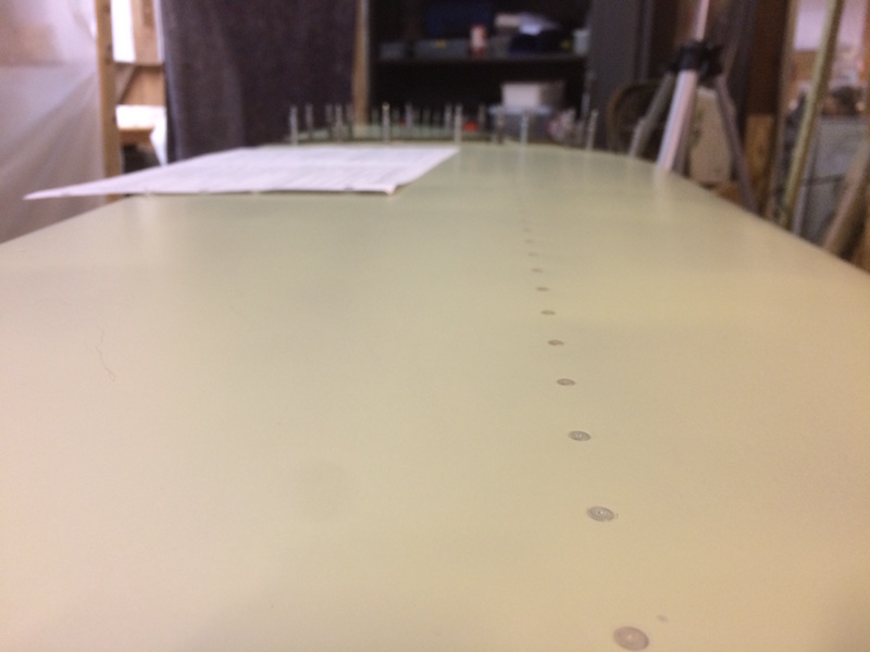

Here is a close up of the rivet holding the shimm
The plans are a little vague on what to do and in what order so I decided to put the whole flap except for the rear spar together with a clecoe in every whole to prevent any room for twist due to movement. Spend the next 3 hours on the floor because that is where I decided to put the Jig and used my flush rivet set to rivet the line of rivets that on the under side of the flap that has the overlap of the bottom and top skin. I used the 3' Yoke as the many builders do as a bucking bar. Worked great. Then I went up the ribs on both sides. According to my rivet checker the rivet called for in the plans for the wholes that are both skins and a rib are to short. I went half a size longer. Somewhere here I had to drill out my first rivet due to overdriving the rivet... Drilling out rivet also still works. I am happy! Opened up the last two wholes for a MK-319BS rivet as called in the plans. The top side of the inboard end rib is no problem. The bottom however is really tight due to the nutplate and the FL706B. I dinged the bottom skin here. I am pissed but there was nothing I could do about it. I think I made the mistake before even shooting the rivet. I guess there is a bit of space between the FL-706B and the skin and while hitting that with the rivet gut I just had to mark it up. Well It is the bottom side and this can be filled. But I still dislike it. The outboard end rib is much easier as the rib are facing outward. This is an easy job with the squeezer. Except for the really last ones. A no whole yoke would be nice. Since I do not have one I will use the indirect rivet method once the rest of the flap is complete. Rivets set and done. Next step I kind of deviated from the plans. They call for putting in the rear spar and first attaching the blind rivets and then the hinge rivets and the end ribs last. I saw no advantage to that. The contrary. with the hinge, spar and skin being countersunk with dimples they are to me the ones that requiere perfect fit. If I leave those to last I run the risk of pillowing. I had some of that on the much smaller hinger of the left elevator at the trim tab attach and it didn't make me happy. So for me it was first make sure the dimples are resting nicely in the countersinks and the hinge and then I went ahed and used one clecoe in every remaining whole. My knees hurt. Not sure why It took me this long to lift up the flap jig onto a table. Used the squeezer to rivet these rivets real nice and slow making sure I did not ding the very soft hinge. This is where I called it a night at right around midnight. Almost 5 hours of riveting... Yea I know I am slow! |
Looks like very nice work!

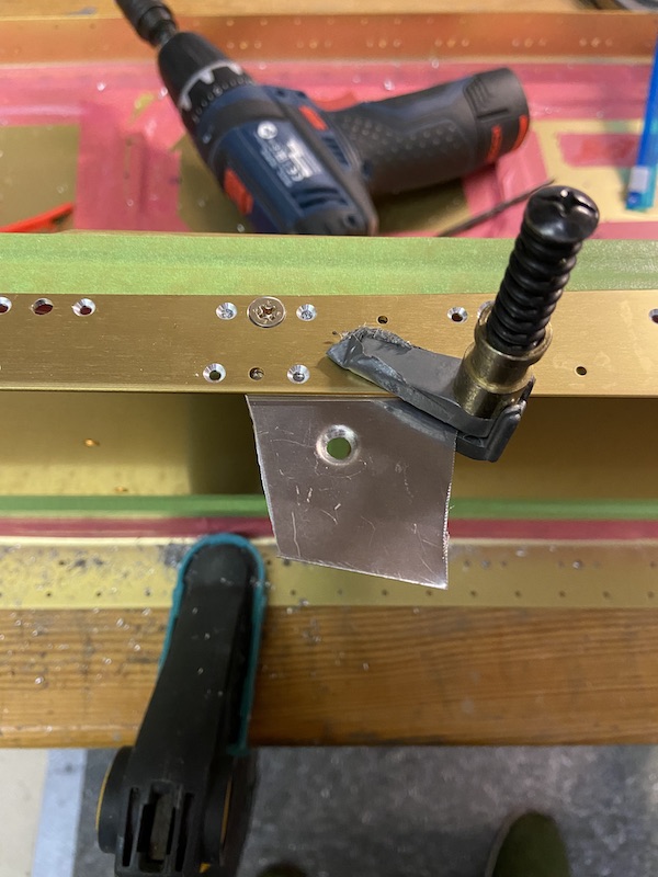

#55
So on the second attempt I had to push the lip up while pulling the pop riveter.
Worked out in the end but cost me about 30 min and was completely unnecessary. Wont be doing that again on the right flap! Other view The last few rivets were to tight for anything but the indirect riveting technique. This is my version and it works well for me... LEFT FLAP DONE! Also first part of the wing kit! |

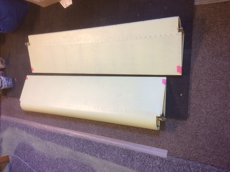

#55

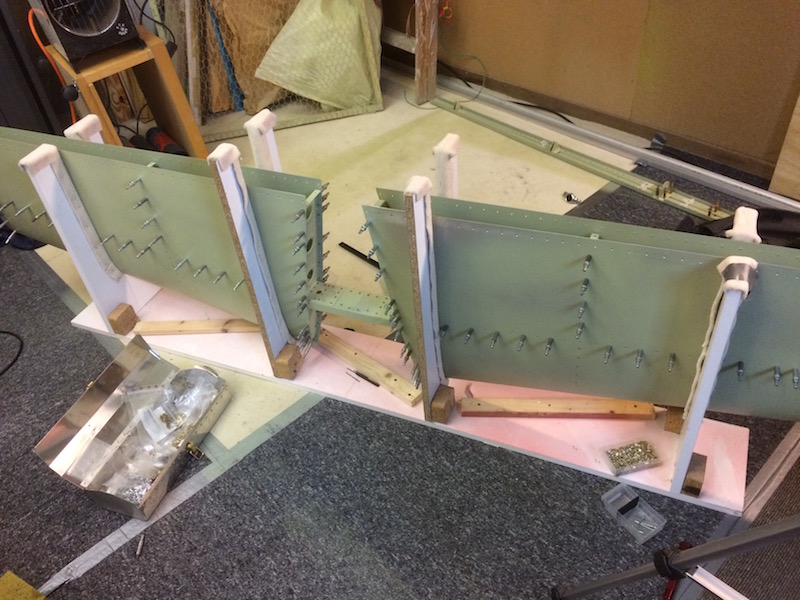

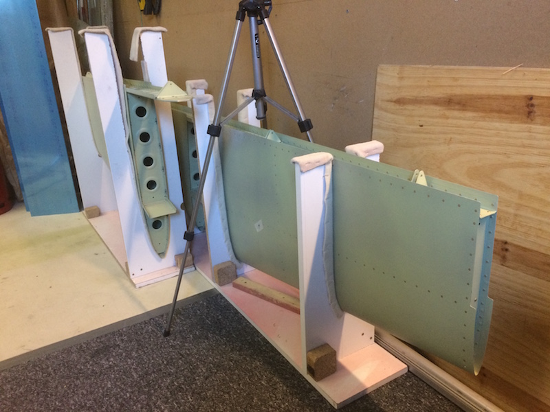

Flaps finished: 40h
I started to repeat each step on the other flap. As one might suspect. It was way easier and went very smoothly without any mistakes. The plans stress about a straight work bench to avoid a twist. I really don't understand that because with the clecoes in the parts there is no way to lay anything flat so the table doesn't matter. Either, way I have no 100% straight table and the flaps came out great. I had them in my jig for the most part...YMMV A note about the time I spend building: I read quite a few builders logs for guidance. Most people show their hours spend on each part. I initially decided against tracking my hours because I figured I don't really care how long it takes. But for some reason now I do want to know. I started to watch the time and writing things down in a spreadsheet. Looks like I am much slower than the rest of the guys on the internet... It took me about 40h for both flaps from start to finish including priming everything with a 2k Primer. All the riveting on the second flap was done in only 4,5h. For me this is the most fun part of the build. I also like the flaps because they are actually done. I don't have to come back to them and do fiberglass or anything. Completely ready to attach. Here is a picture of both of my finished flaps in a newly build holder. I have 2 empty places on it for the ailerons. GUESS WHATS NEXT? |

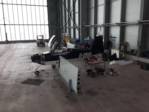

#59
Well, the rebuild RV7A is complete and so I return to building a few parts that I have given buddy so that he can fly this summer... Like the VS.
Yup I just build my second one of these. You would think it would go a lot quicker, but for some reason that was not really the case. With Priming and de burring all in was about 20 hours. Even though I knew what I was doing this time around and didn't have to think about it to much... So for those of you that have stated they can build a whole empennage in a weekend. I wonder how much de burring is included in that. Or I am simply very slow. |

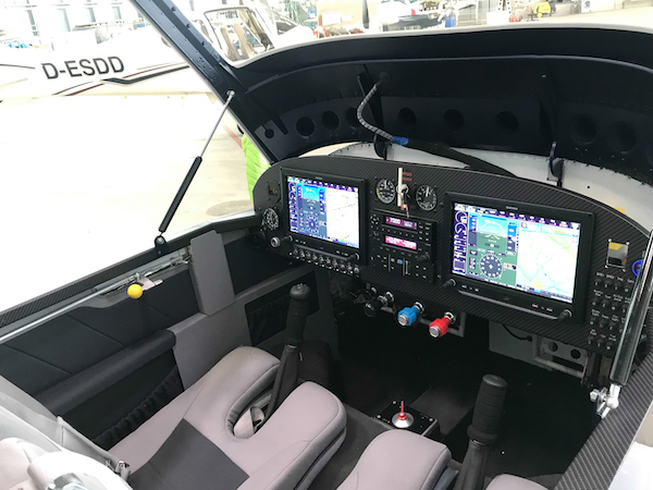

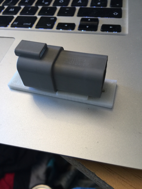

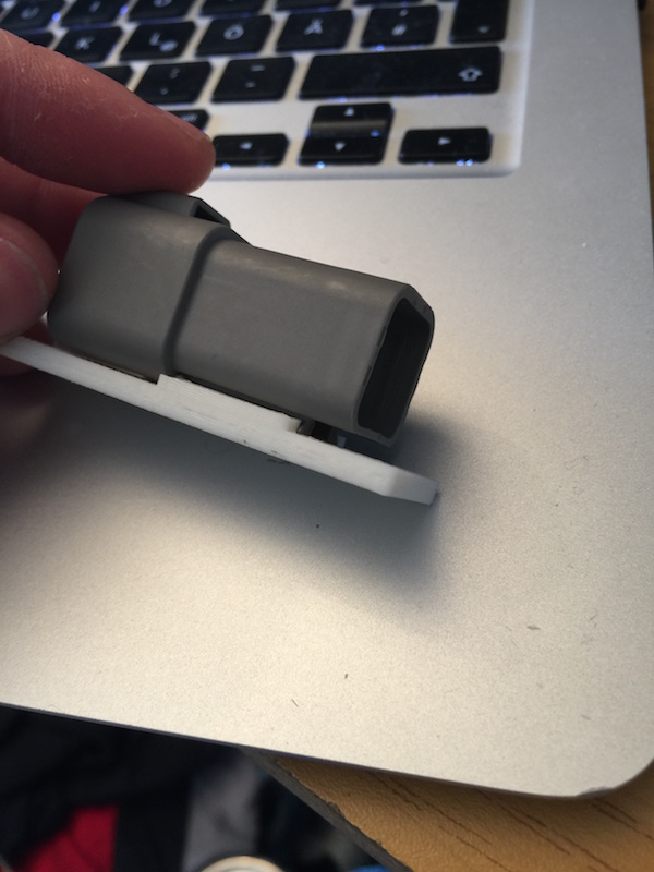

While rebuilding the the other plane I got to fast forward quite a bit into cable, connectors and avionics. Gave me a lot to think about. I had been trying to not do that because buying avionics early is kind of silly...But they are so much fun!
Anyway. We replaced a few connectors and while doing so I got to try out a few different kinds and that was great because I know what I like and what I do not like. I like the DEUTSCH series connectors. They feel nice and are good to work with. But at some point we had to figure out how to attach them to the air-frame so they don't move around. Double sided tape will do the trick but since I build this 80$ china 3D printer I had to put that use. I have never designed any parts. So this is my first try. I am printing ABS and use the "raft" to stabilize the print. In this case the raft takes longer to print then the part but it does work well. First print in coarse quality. The holes are to attache with pop rivets to a rib or similar structure. With the connector attached. Fit is very tight. I don't think it is going anywhere. fun little 3 hour project. Necessary? probably not but what else am I going to do with this printer? :D |

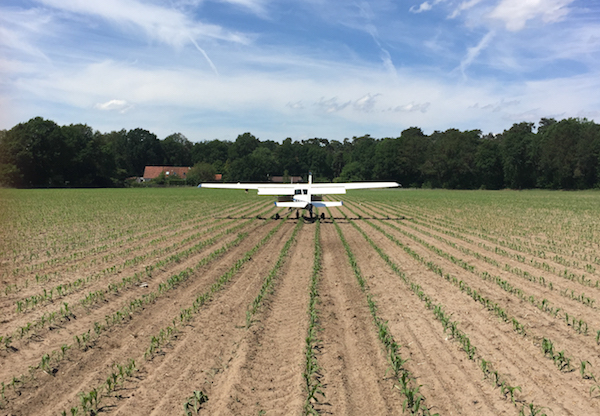

But, a lot has happened: Remember why we do those "simulated" engine out trainings on our BFR's? Well, I do one every year either for club currency or for the rating and while it is all well it doesn't compare to the real thing! At 250h total time I am a just starting and I know it is a risk but never really thought it would actually happen... A few weeks ago I was PIC in a friends good old 152. He had to give up his medical for a bit (already has it back) but still wanted to fly so he asked me to fly him around in his plane. He is over twice my age but we have fun sharing one of the best hobbies out there. It was a hot day, we were close to MTOW and climb was pretty slow. A few minutes later just shy of 2000ft still at WOT the engine sound changed. A quick glance at the gauge: 1500RPM with everything full forward. "OH SH**" I tried to trouble shoot while getting that adrenaline rush you would expect. Everything happened so quick. I lost about 600ft when I realized I will have to put her down NOW. I was maybe 1000ft-1200ft AGL. Looked left, picked a place and called a mayday and set up for landing. I still had partial power until I shut her down before touch down. I never thought it would happen but it did. I am pretty thankful it was a C152. So I was just really lucky that nobody got hurt. Happy to be here! |
Nice Job
Glad you all are okay and you had a field to land in. Looks like you did a great job and didn't even tear up the vegetation! Great job. :D
Great Job!
Way to go!
Best, Merrill |
Oof! That stinks, but really glad you two are both OK and it looks like the old bird is pretty good too. Any idea what was the cause of loss of power yet?
Awesome Landing!
Glad you are OK.
Not much damage to anything, farmer's field; not much damage at all. Did you have any issue with direction control? Looks like you handled the "soft field" very well! Best regards, Mike Bauer |
Wow, glad to hear you are all good. Great job keeping it together for a nice landing!
Way to go!! One of the best instructors I had during the countless semi-annual checkrides I had to take told me - it doesn?t matter what happened to cause an abnormal or emergency situation or what procedure you followed - but if you can put the airplane down without injuring anybody or bending any metal, whatever you did was good and acceptable. It is incredibly hard to argue with success, and whatever you did was successful.
Nicely done,
Glad to see you followed your training. Unfortunately many of the fatalities we read about are simple emergencies followed by a stall. It is very difficult to fight the natural urge to pull the stick/yoke back. Again well done sir. |
well done!
Bravo!!!
Well done - I often wonder if I would have the same ability to keep calm and fly the airplane. Good job.
Let us know what you find out about what happened. |
Thanks Guy! This happened a few weeks ago and I had to step back and think about stuff for a bit. Didn't fly anything during that time. I went back and made a list of stuff I did well and all the things I was told in basic training that I didn't cover. Or at least I don't remember doing. It's a bit of a blur. The second list was much longer!

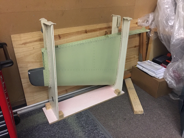

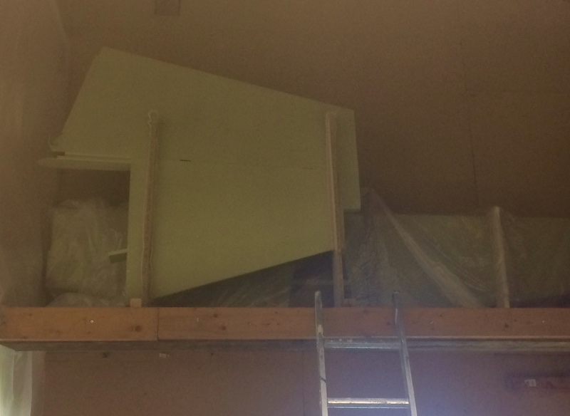

Back to my own bird...Honestly while I now know how to build tail feathers, I can't say that it goes much faster then the first time around. De burring and priming prep takes forever and I was actually somehow more prone to mistakes than the first time. Managed to get a slight dent into the bottom skin of my new HS. It's not bad but it sure bothered me for a while. Anyway, here it is:
All done... (minus fiberglass) Now on to the rudder and I will be back on track with the wings. |

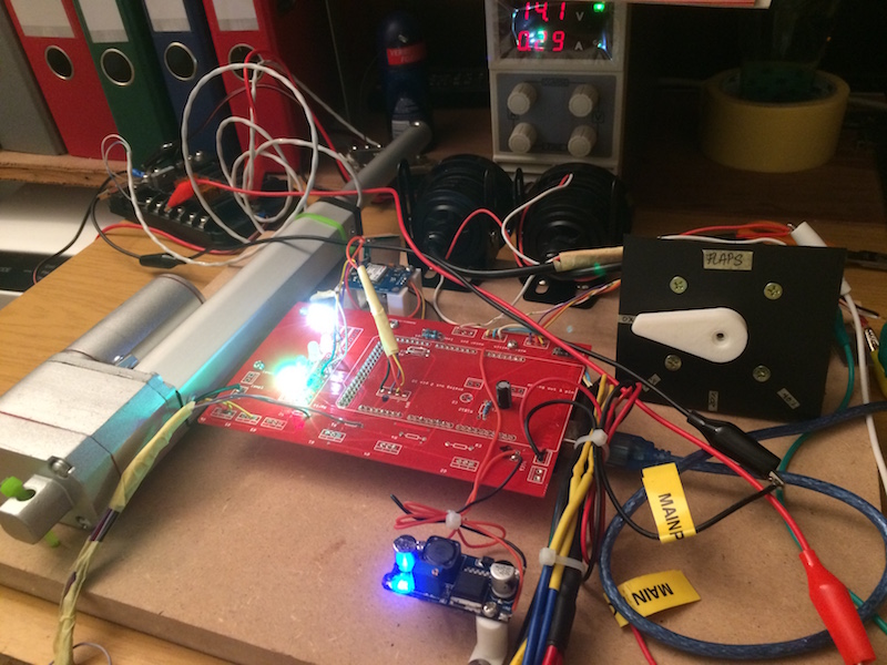

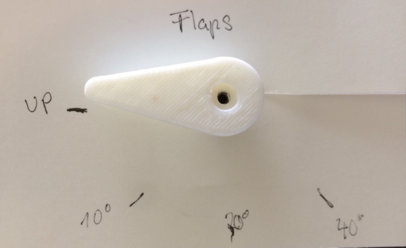

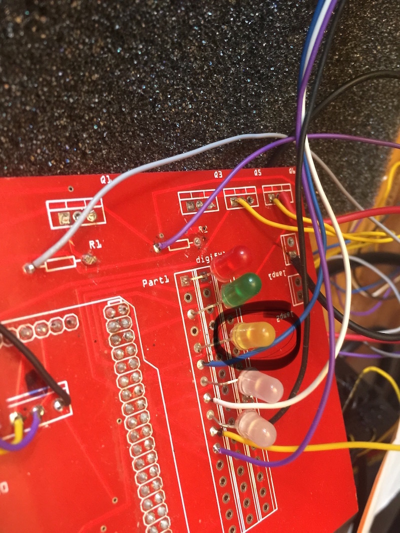

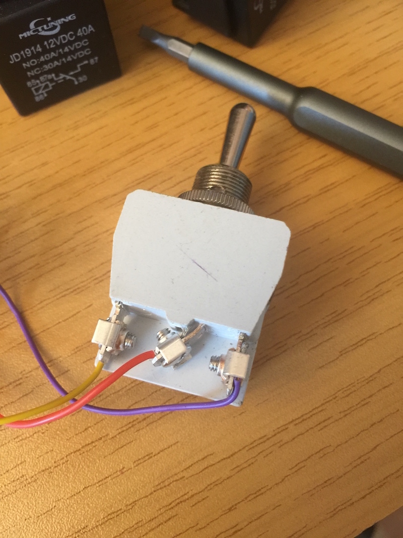

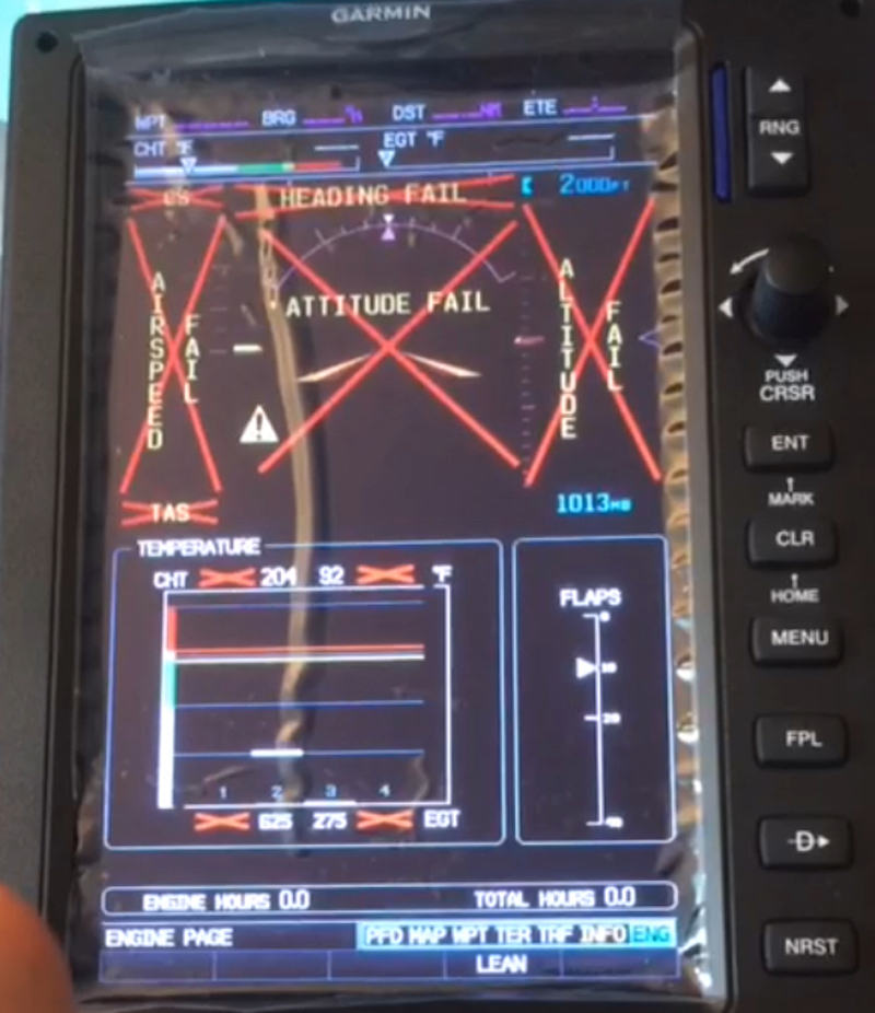

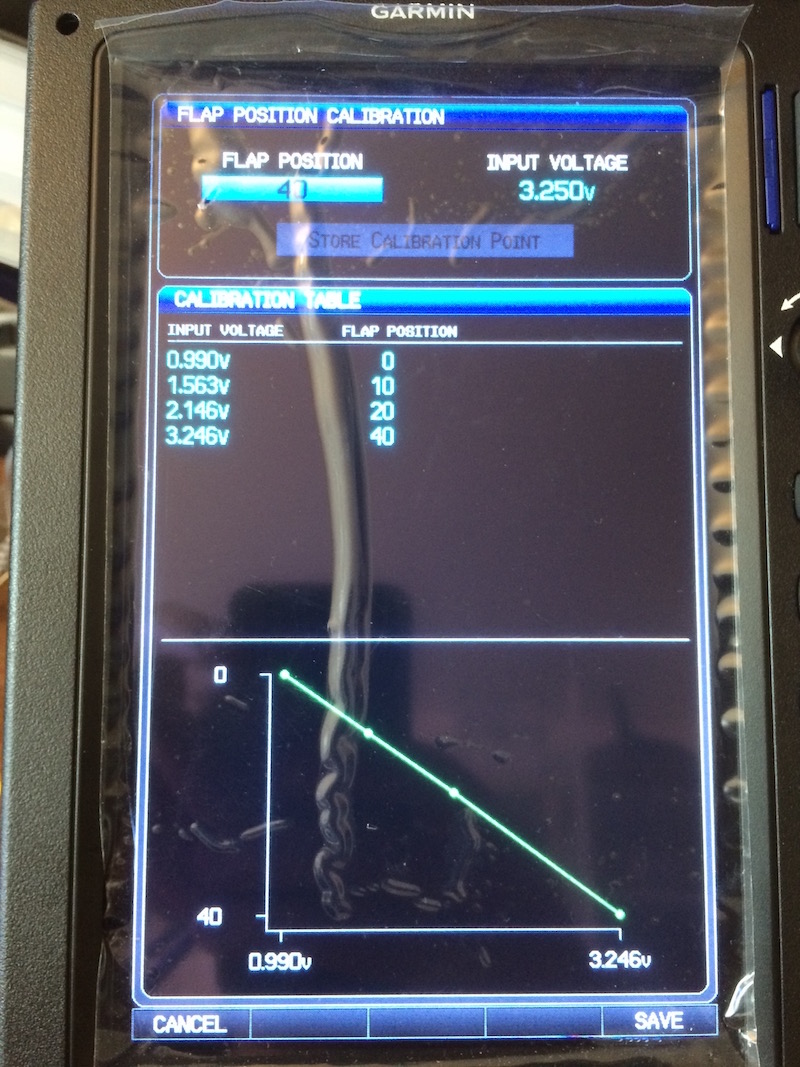

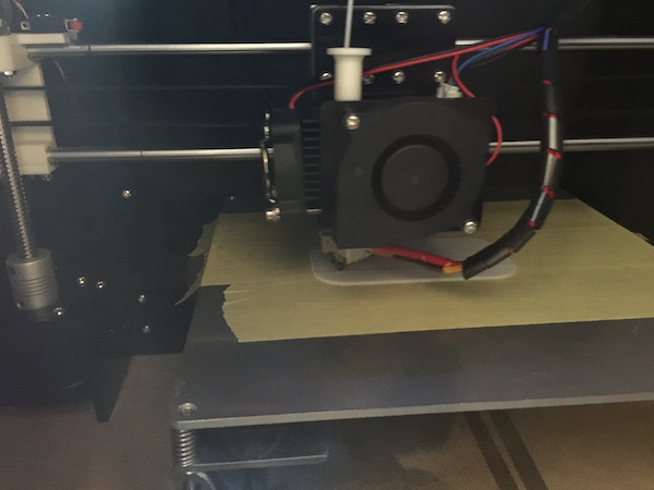

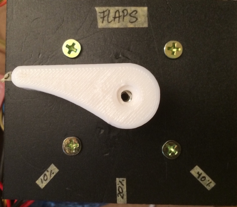

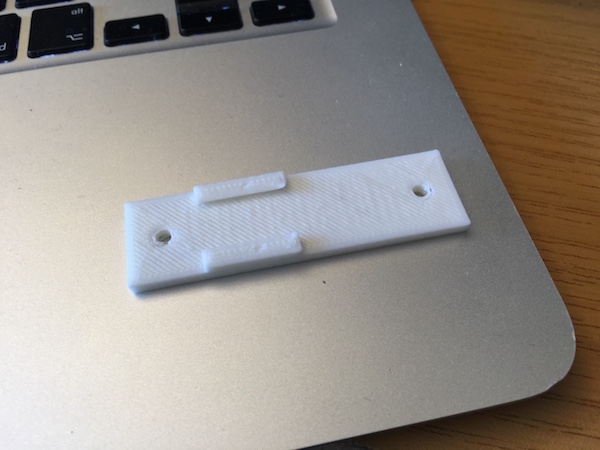

Sometimes at bed time when it would be to late to start anything else I tinker with some electrical projects.
I have read a bunch about the standard Flap motor not being "perfect" During the rebuild of the other RV7A with G3X system the flap position was missing. So I added with a ray allen position sensor. It also had the "Flap Positioning System" by show planes. Motor Sensor mounted to the motor Potentiometer mounted to the motor This kicked of this idea. There is got the be a simpler way. What I came up with is a motor that has it's own potentiometer inside. Then I got a arduino board to play with and after about 3 months I got the first beta version that does everything I want it to do. My system mounted to a board I had originally copied the switch that all the other systems use but then changed my mind to a rotary knob. From this: To this: I made another version but I havent decided on the final one. (these are rough prints from the 3d printer. I would like to get the final one made out of Aluminum CNC. I also have some LEDs. they are on the board now for testing but I want them to be mounted next to each position of the flap switch --- Then I added a GPS and that lead to a few new possibilities. I was able to set up an over speed protection on the flaps. I also included a wig wag module. This is also driven by the GPS. Now the last piece of the puzzle was to make an output that the garmin g3x systems can read. (I suspect others would work too) I borrowed the gea24 and a g3x display from a friend to do this test. Works like a charm --- So far I have only tested the system in the car while driving and it performs great there. |
I really like the "rotary" flap switch! I am in on that!
Thanks!
I know Cirrus ad Aquila both have pretty much the same design although with only 0?/ 15?/ 30?. But all my RV friends at the field like the other switch better. Maybe its because they like what "everyone" is using. I think I will stick with the rotary. btw. witch of the printed switch heads do you prefer? |
Although I would like to know its overall length, it seems long but just another guy's opinion... maybe a coin for perspective. |
