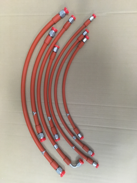

Considering the TSflight lines hose kit, instead of stock ones.

Aircraft Specialty 06-09-2020 10:34 AM
Originally Posted by oren_rokach (Post 1437681)
Reviving this thread after 4 years of no comments
Am about to order the FWF kit.
Any other suggestions I can delete or add from Vans?
oil cooler?
Things that are missing in the FWF kit?
Thanks!
Oren
Oren,
Thanks for the opportunity to earn your business.
Here is a link to the RV-10 FWF hose options as well as the items you would delete from Vans to install our FWF hoses.
http://aircraftspecialty.com/rv10ff.html
They come in a standard firesleeve, or our new integral firesleeve option.
Both have a 10 year warranty on them.
Feel free to give Tom or I a call with any questions.
Steve
