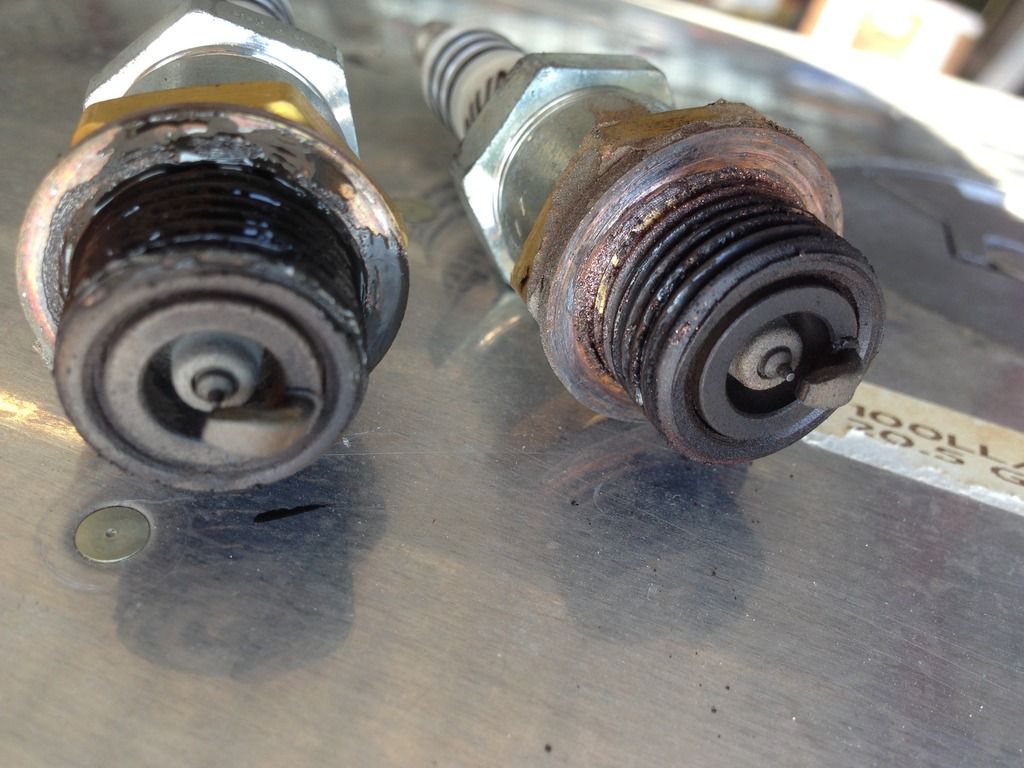

So just got done doing some more trouble shooting. I fired the airplane up and it was rough running, it wasn't obvious on the G3X because I had my engine monitor on the checklist page. With the checklist displayed the engine parameters are truncated and only show hottest EGT/CHT. I switched to the main engine page and it was obvious the #2 was not firing correctly with a 500* EGT, exactly as seen on the engine data on the ramp the other day. I aggressively leaned it and #2 started running normal, again about a 1 minute event.
I did another extended run-up and cautious takeoff and short flight but couldn't reproduce the problem ROP/LOP. Landed, fueled up and the re-start/taxi back to the hangar was all normal.
Pulled the cowl and started an early oil change. Carb shows no signs of leakage on the outside or in the throat. I did speak to the Mark at Marvel Schebler (great resource) and besides some sort of leakage/debris carbs generally don't "fix themselves."
At this point I'm fairly certain it is an ignition/spark plug problem. I pulled the plugs on the #2 cylinder and I (not an expert) think they look fine, granted they were firing just fine 30 minutes ago. They are NGK BR8EIX 5044 auto plugs with adapters smeared with anti-seize.
I measured the spark plug resistance at 3800-3900 on both warm. Plug wires measures 800-1250 ohms with the longer wire measuring 1250.
Before I just put new plugs in it and fly it how do I rule out a sticky valve?
Mike S 04-01-2015 05:08 PM
Just an FYI/observance here, I believe you should install the plug adapters, and leave them in the head, remove only the plugs.
What are the other plugs in the engine looking like, and testing for resistance?
The fact the problem comes and goes would support a sticking valve issue...................
crabandy 04-01-2015 06:05 PM
Mike S,
I put the socket on the sparkplug and both come out, it's consistently been that way when I remove them. I finger tighten the adapter on the sparkplug and then screw/tighten that assembly to 30 ft/lbs via the sparkplug. All the plugs looked similar when I removed them, but I didn't put the ohm meter on them.
crabandy 04-01-2015 06:07 PM
I do recall a small burble while switching ignitions during a runup on several occasions within the past 15 hours. With the carb jetted slightly richer now perhaps it's a plug/fouling issue?
