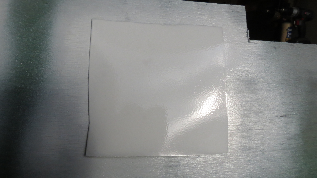

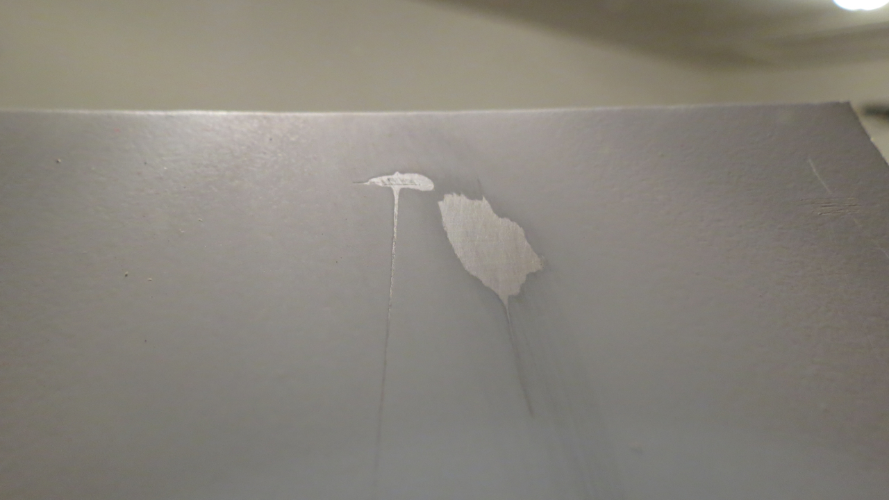

Finally, last Saturday was D-Day. I tinkered with the gun a bit, first shooting water and then thinned latex paint to get a feel for controlling spray pattern and such, then I decided to cut some scrap into test patches, mix up a batch of primer, and try it out. The results were...acceptable. I got carried away on one test patch and made some nasty runs, but the others I got a fairly even finish, though there's definite orange peel texture. Still, the semigloss finish and color look nice, and I think it'd work great for the interior in terms of aesthetics.

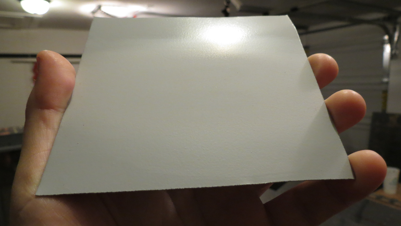

The best of all my test patches:

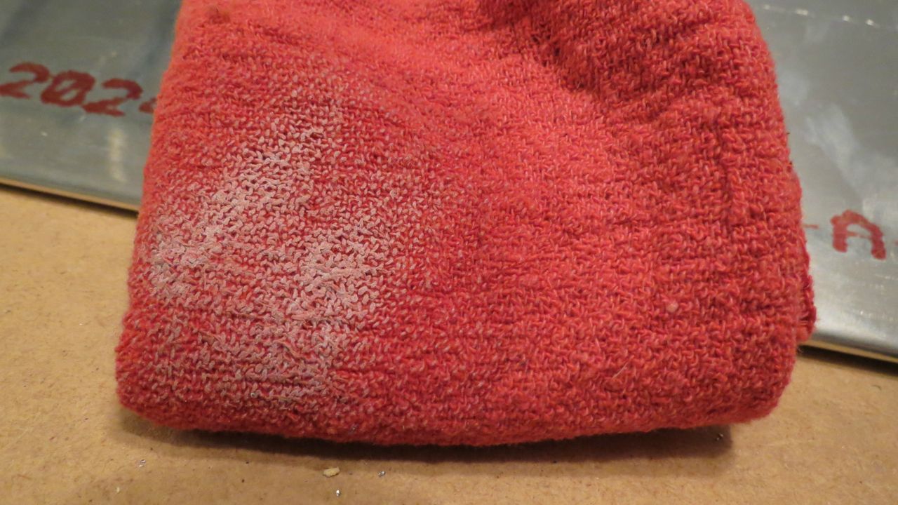

Tonight, after letting the patches cure for a few days, I did some durability testing. The first test was a brisk rub with an acetone-soaked shop rag. It was immediately clear that primer was being removed; the orange peel texture as well as the gloss vanished from the rubbed areas.
Upper portion of this patch is untouched; center area has been rubbed. Note the difference in gloss:
Ruboff on the shop rag:

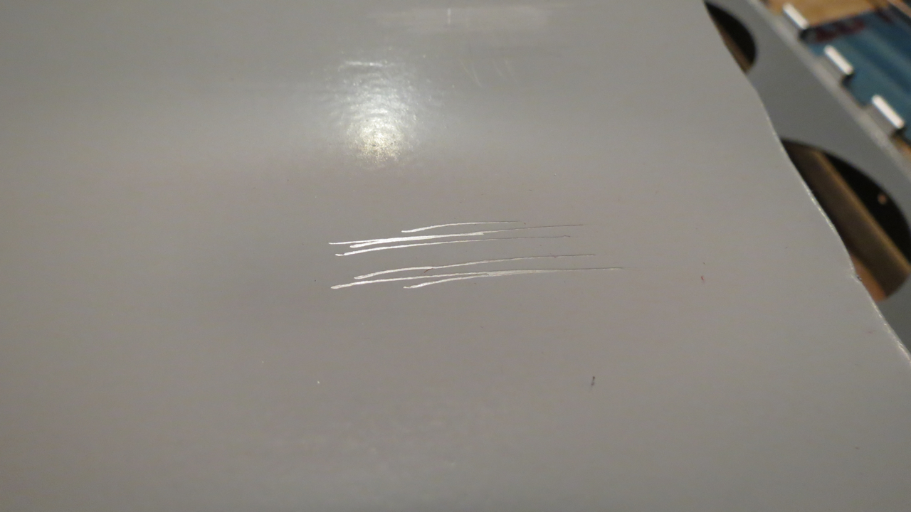

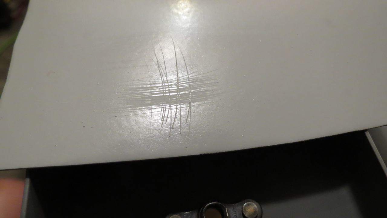

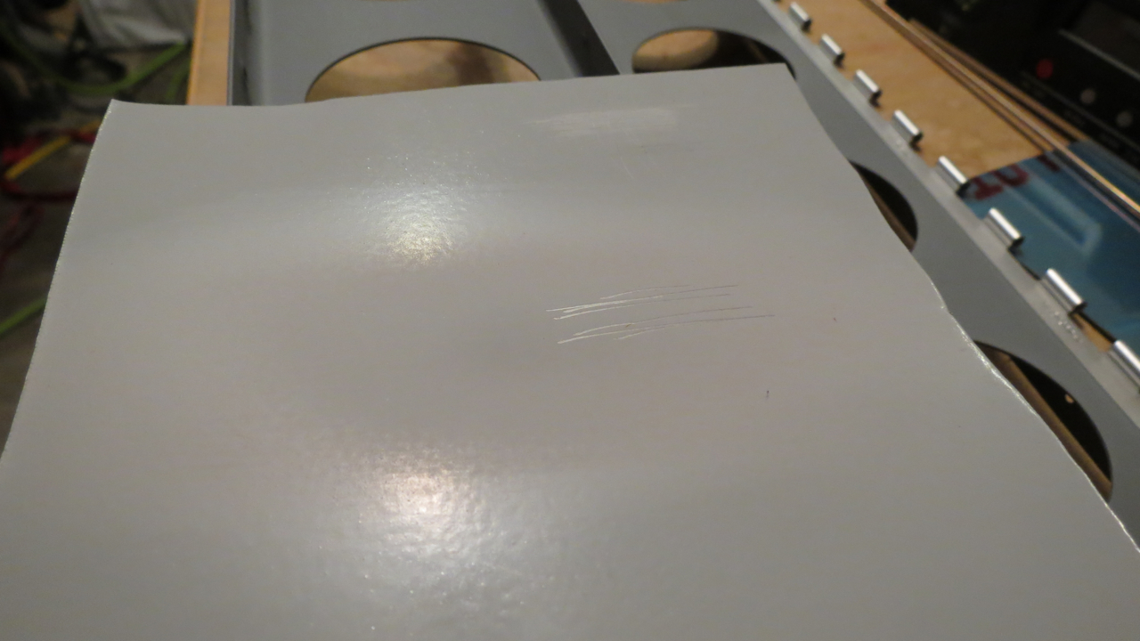

Next I went inside for some scratch testing with a thumbtack. The areas rubbed with acetone definitely seemed softer than the untouched parts; the scratch almost immediately showed bare metal, and a little back-and-forth scratching revealed a large area of Al. The area where I hadn't rubbed with acetone was tougher; light scratches were barely visible, and heavier scratches didn't seem to go right down to the metal. I was still able to get down to the metal with some concentrated back-and-forth scratching, though.
Scratch test results. Left side is acetone-rubbed area, right side is untouched. Note how much more metal I was able to reveal in the acetone-rubbed area:

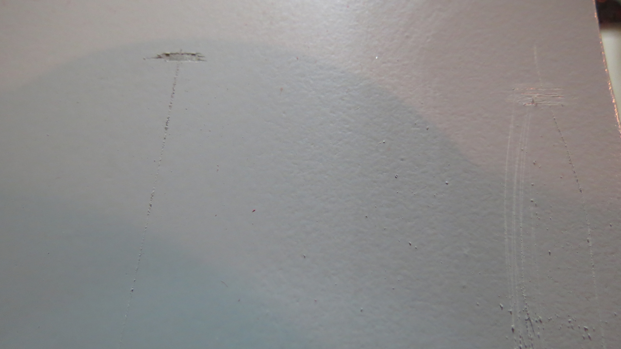

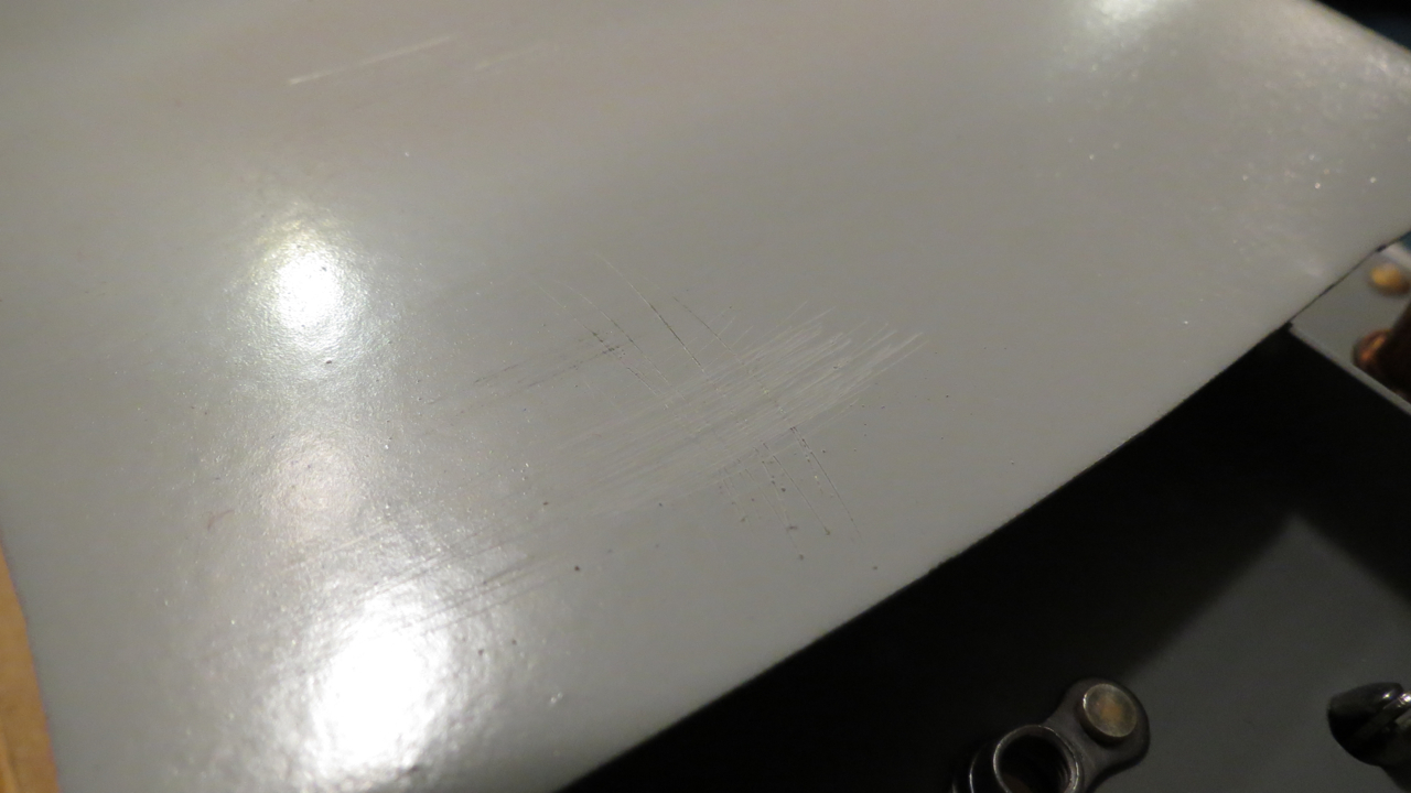

Update: Tonight I grabbed another test patch for some abuse. At this point, the primer has had about ten days of cure time. Acetone resistance did seem to be improved, though a good brisk rub did still remove some primer.
As before, the dull area can be seen in the center of this patch:
Doing a second acetone rub after some scratching reveals bare metal as before:
However, scratch testing on primed areas that I didn't hit with solvent turned out quite well. Tapping the primer with the point of a thumbtack revealed no visible damage, and light scratching with the thumbtack made marks that were only visible under careful inspection.
It took quite a bit of repeated abuse with the thumbtack to make these scratches:

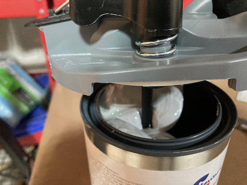

Mixing Mate
Is anyone successfully using ekopoxy with mixing mate paint lids? I hear it's really thick so was wondering if this would cause issues when mixing and pouring (perhaps too thick to pour).

  • It's a nightmare to mix in it's own container. When trying to mix in it's container, you end up with a blob on the of a stick.
  • Consistency out of the can makes for a lot of waste when doing small batches.
A few hints use:
  • Purchase a couple of quarts. Then buy a gallon can and use a can opener to cut the bottom out of the EkoPoxy quarts and put the contents into the gallon can. Much like getting dog food out of a can. You'll end up with a half gallon of product in a gallon can. Makes mixing a breeze and minimizes waste.
