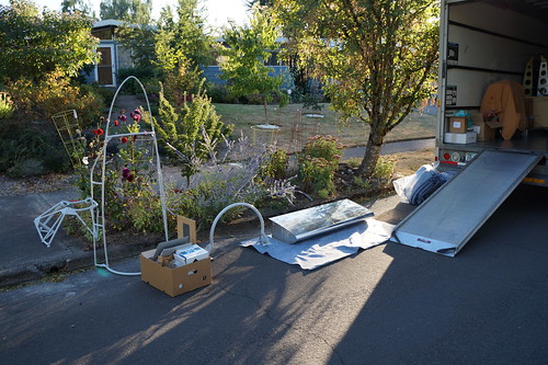

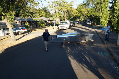

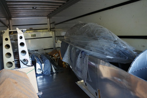

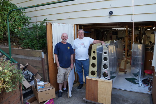

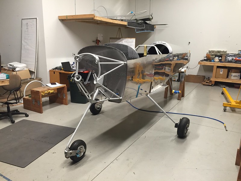

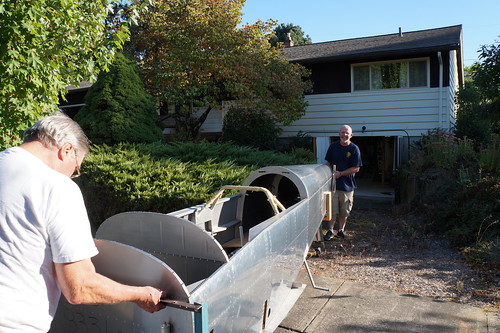

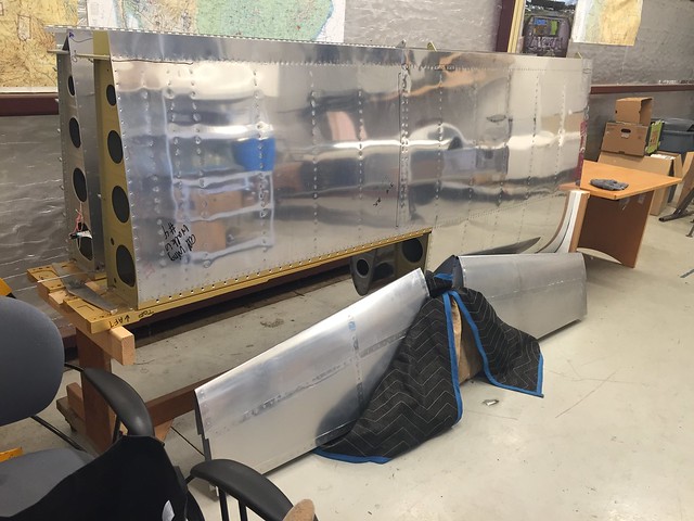

A few photos from the move:
My friend Jim and I as we get the wings out of his basement shop.
There were more parts than my mind had pictured before actually starting the move. They just kept on appearing.
Fuse removal.
Temporarily a tail-wheel.
Justin got in a little flying.
On the truck
Finally unloaded in the hangar. Took quite a bit longer than we'd thought it would!

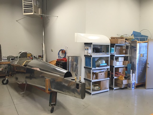

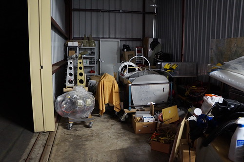

There was "stuff" in the hangar that needed to be relocated before I could move in, so that was the first step. Then I cleaned things up and started moving the kit inventory. I finished moving all the kit parts - and most of my tools - to the new hangar this past weekend. And, I got it mostly organized. I've discovered there are a number of tools that I'll need to pick up sometime soon, but nothing that prevents me from getting started now.
A couple photos of the new work location and (just barely) getting started there with work on one of the wings.

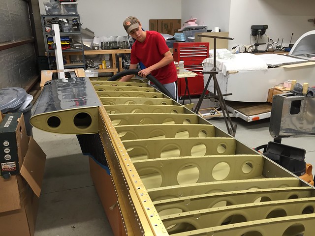

We did some work to prepare for riveting on the remaining skins - Poser by greghughespdx, on Flickr
Teenagers like shop vacs - cleaning out some metal shavings by greghughespdx, on Flickr

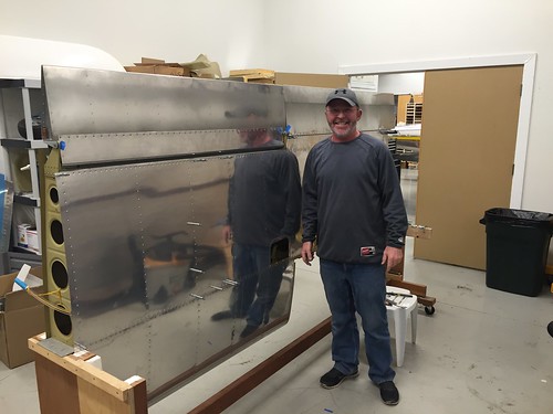

greghughespdx 01-14-2015 10:29 PM

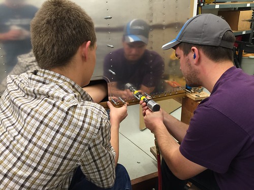

Update
Probably should update on the work that's been done the past couple months. Work and life have been especially busy and I had surgery at the end of the year, but I find time here and there. Thank goodness the hangar has heat, or I'd almost never be in there hah. So, a pretty big update this time around.
In the interest of full disclosure and exercise of healthy humility, this is what I did immediately after driving my first rivet in the left wing… Lots of good progress since then, though!
Justin and Aric got in on some left-wing rivet-driving action early on.

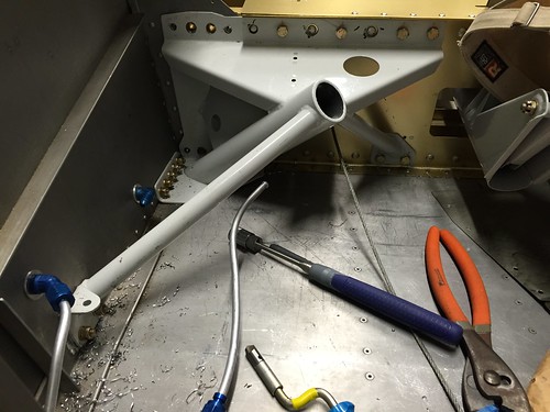

In the fuselage, elevator pushrods and bellcranks, rear battery tray, -A gear weldments, and some floor/wall work.

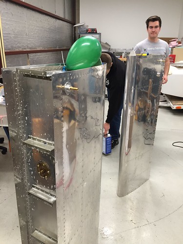

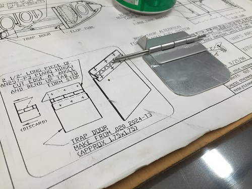

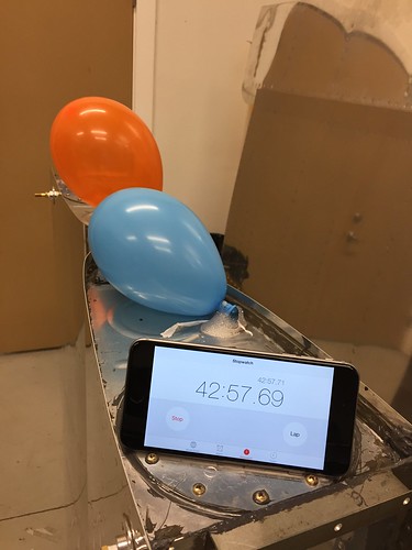

Lots of work on fuel tanks, including sealing and setting up with a flop tube in the left tank, and all the associated stuff like the trap door to restrict flow out of the first cell, relocation of the fuel sender, etc.
I've really come to .... appreciate .... proseal. :rolleyes:
greghughespdx 01-14-2015 10:32 PM

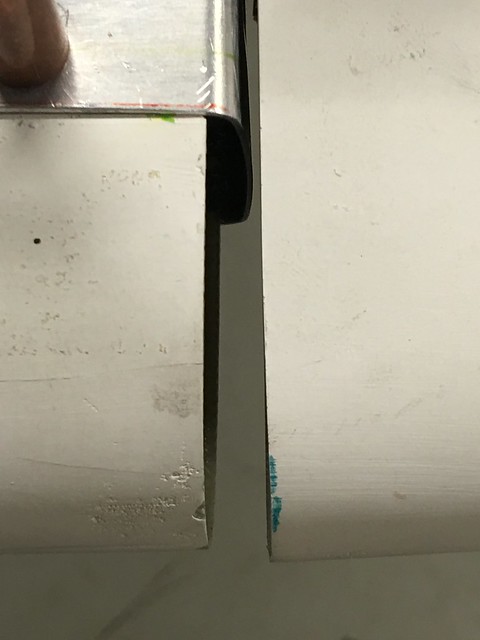

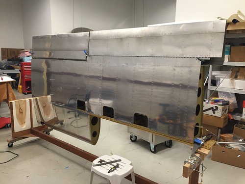

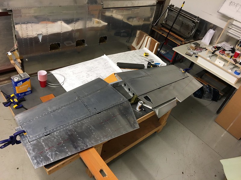

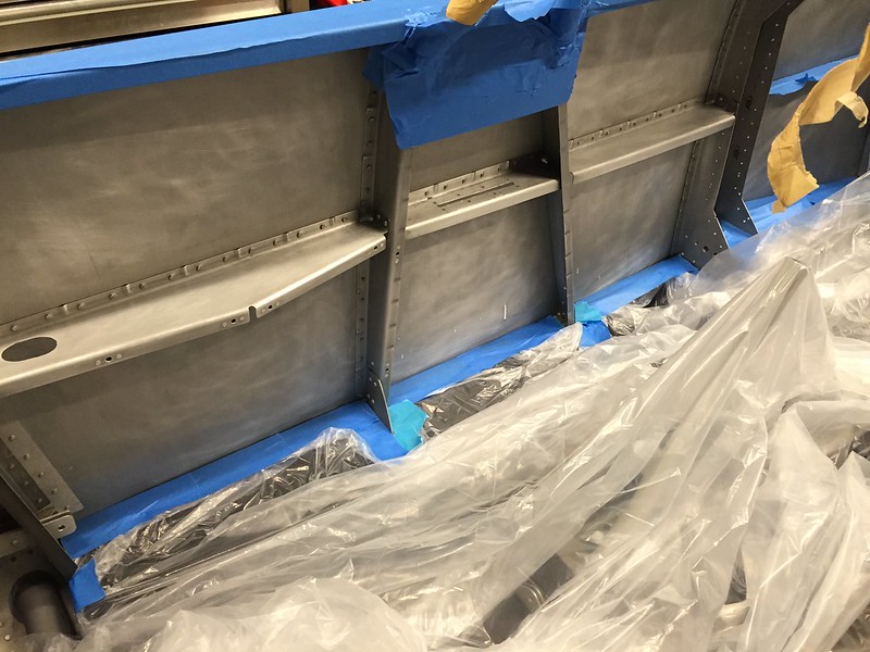

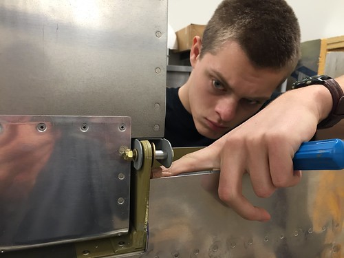

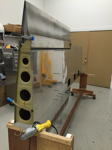

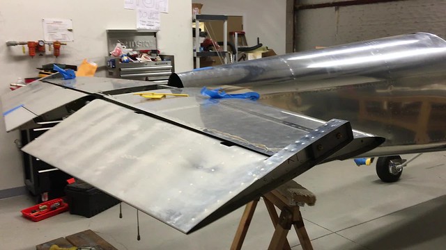

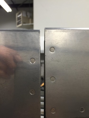

Flaps and ailerons and all the avoidance of perfection that comes along with doing that (I've been learning a lot the hard way).
Trailing edge alignment. Ugh. A local friend who knows better than pretty much anyone else guided me on this one: Keep calm and build on. :)
greghughespdx 01-14-2015 10:34 PM

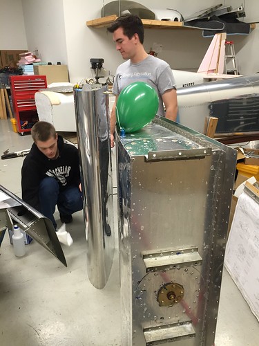

When you know you have a high likelihood of leaky tanks, its easier with people who are willing and able to provide moral support and friendly help:
Four sessions of seal/wait/test later, I finally found success today. Had to dig out some proseal a couple times and replace in rear baffle corners, and used 290 Loctite to seal one leading edge leaky rivet with great success per Vans instructions. But I didn't have to cut baffle holes. In the end, the only remaining leak was a very slow one, and was located in one of the balloons. I'm calling 'em done!

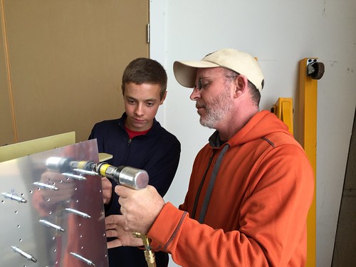

There are a few guys that I need to say thanks to already and want to recognize, even this early in the process. Young people in aviation is something I'm pretty passionate about, and all these guys are really motivated examples of the future of what we love to do.
Thank goodness for this kid: Justin?s a great help, a good guy, and has taught me a lot in the building process so far. I learned to fly first, he learned to build first. I took him with me on my trip to OSH in 2014, now we?re hammering on my RV together. He?s built a couple RV-12s already and he?s only just turned 18. He loves to build and fly and has even designed a plane or two of his own already. In the future I predict with confidence that his designs will grace the skies, just you watch. (No pressure, Justin. ;) )
Aric's another truly good guy and works at Boeing. He brings a valuable point of view to almost everything in the shop - usually making an unnecessarily complex task or problem much simpler, hah.
Tyler?s new to building, but is a student pilot here in the Portland area, and has helped me drive and buck a whole ton of quality rivets.
And Davis is one of our TeenFlight kids, a member of the class that?s just now finishing an RV-12, N113TF. He also maintains the blog for the class at http://teenflight.blogspot.com/. Aric, Justin and I have all been working as mentors with that group for the past year as they have learned to build the -12. Davis has come over and helped out a few times on the -8A, nicest kid you?ll ever meet and a good hand with a natural ability. He also likes to do fiberglass work. As in, truly likes it. Yep, you understand where I?m coming from on that one, hah.
Thanks to all you guys for making the project so much more fun and for keeping my motivation up!

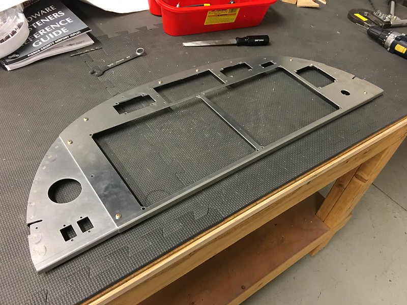

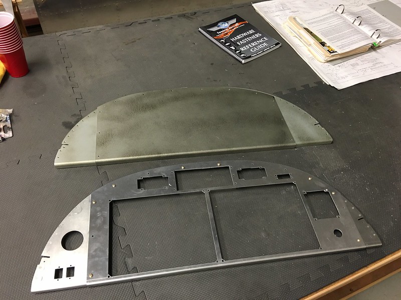

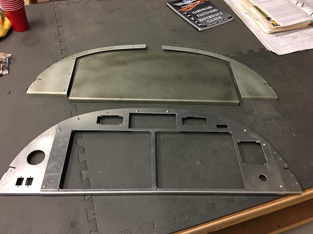

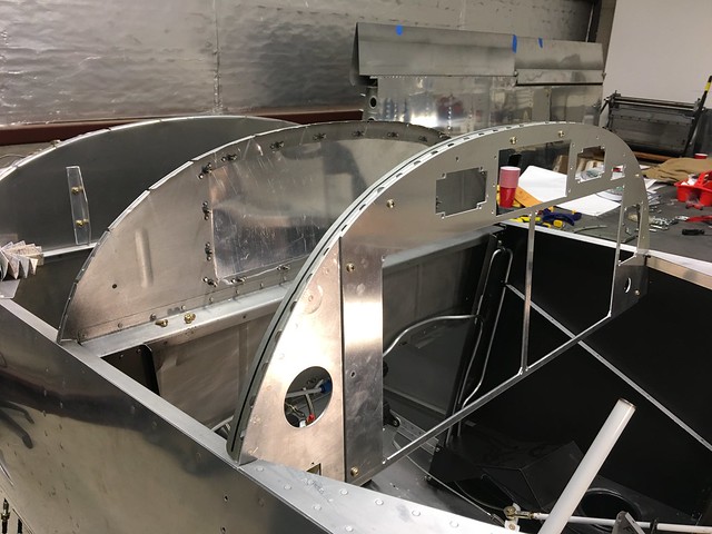

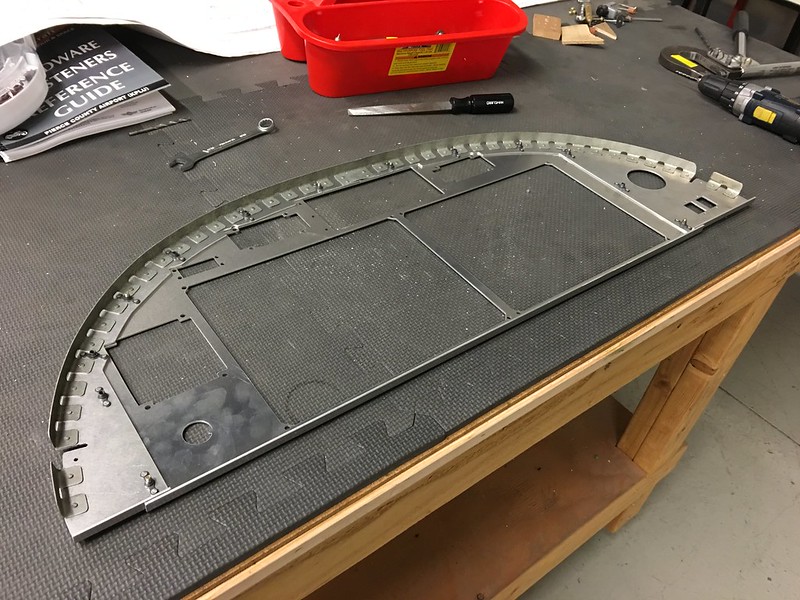

Most recently - just this week in fact - I started early work on the new panel. Working with Rob and family/team at Advanced Flight Systems, with one of their Quick Panel designs. It's extra nice to be a stone's throw away from them and to see them on a regular basis, but really the modularity and clean designs are a blessing to anyone who takes advantage of their stuff. Everyone will have their own ideas and opinions, but Advanced has put together a great system. My blank kit panel was already assembled, so when Rob told me he'd had a panel cut for my 8A project, I headed over and picked it up, and drilled all the rivets out of the old panel flange, and got to work on assembling my new Quick Panel structure.
The Advanced panel is laser cut, and exactly matched hole-for-hole the circa-2004 panel parts from Vans. The "side section" portion of the outer frame is smaller than the stock Vans design, in order to accommodate more electronics in the panel center section. Precision stuff, and great quality. A couple quick hours of drilling, countersinking , deburring and riveting later, and it was ready to test fit and send out soon for powdercoat!
Old vs. New:

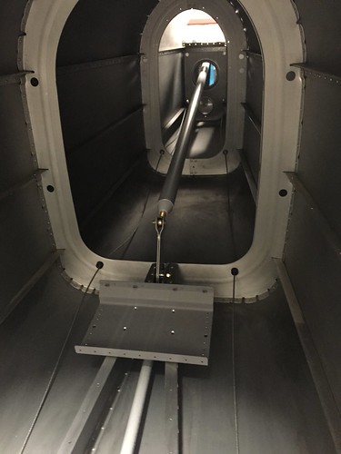

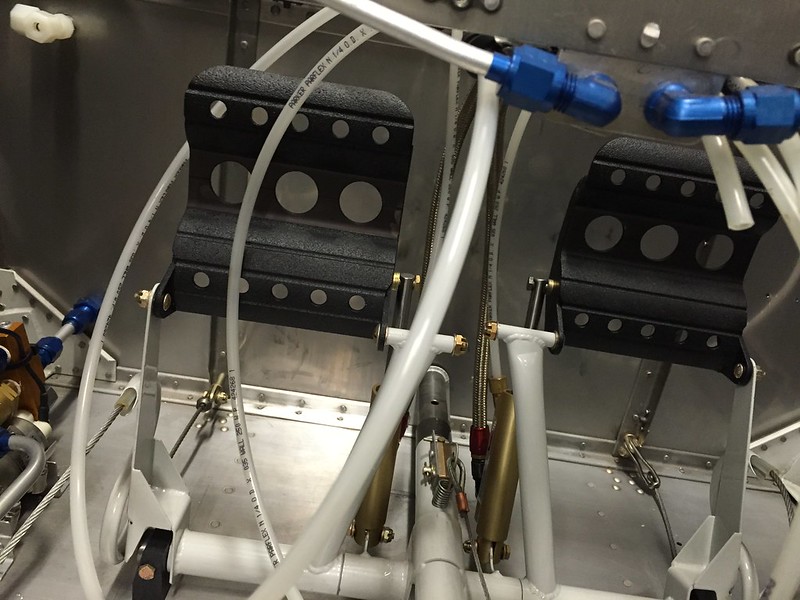

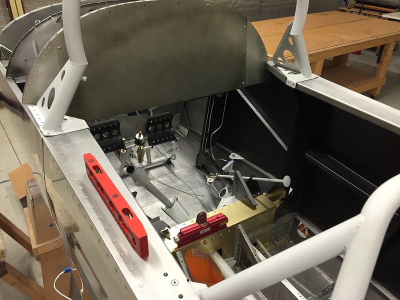

Installed some new and different rudder pedals, an alternative to pedal extensions. They have an indent to keep your toes off the brakes while working the rudder. Got them from Paul at http://controlapproach.com/ (who also flies a RV-12 located one hangar door down from me). He makes RV-10 pedal setups and a couple of us have installed these new pedals in 8's.

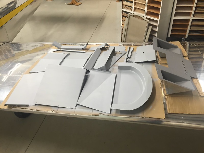

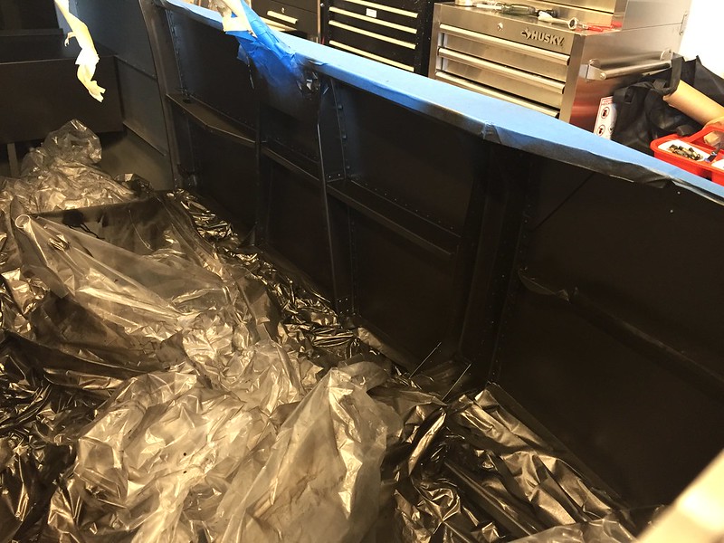

Plenty of interior type work, prime, and then some bronze paint, etc...
Avionics bay access:

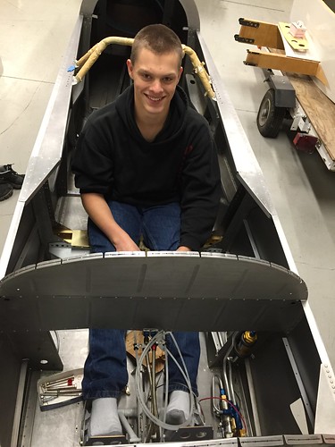

Back seat rudder pedals:

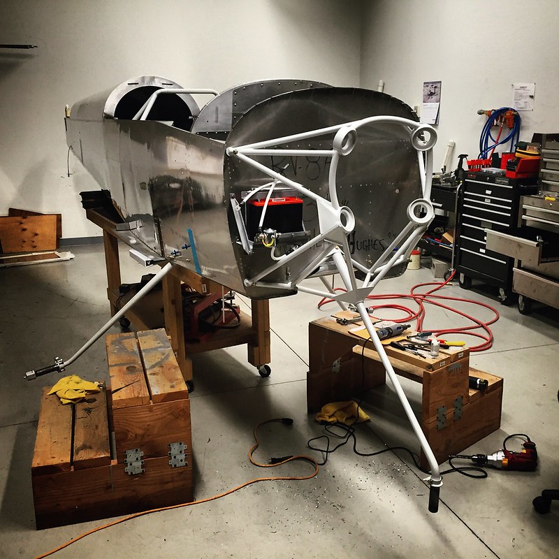

Landing gear and starting FWF:

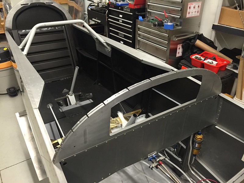

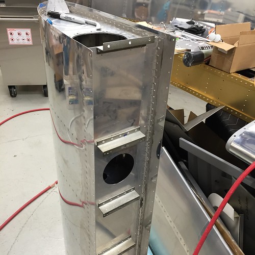

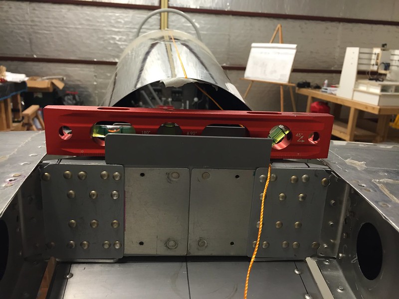

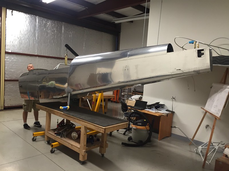

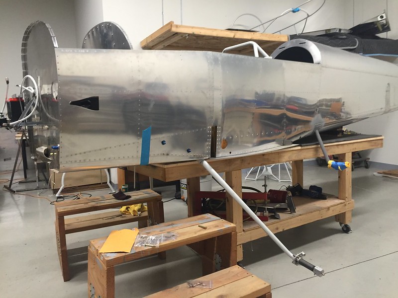

Service bulletin surgery on the horizontal stab and installing it on the fuse (the first time (of many)):
greghughespdx 11-01-2015 11:28 PM

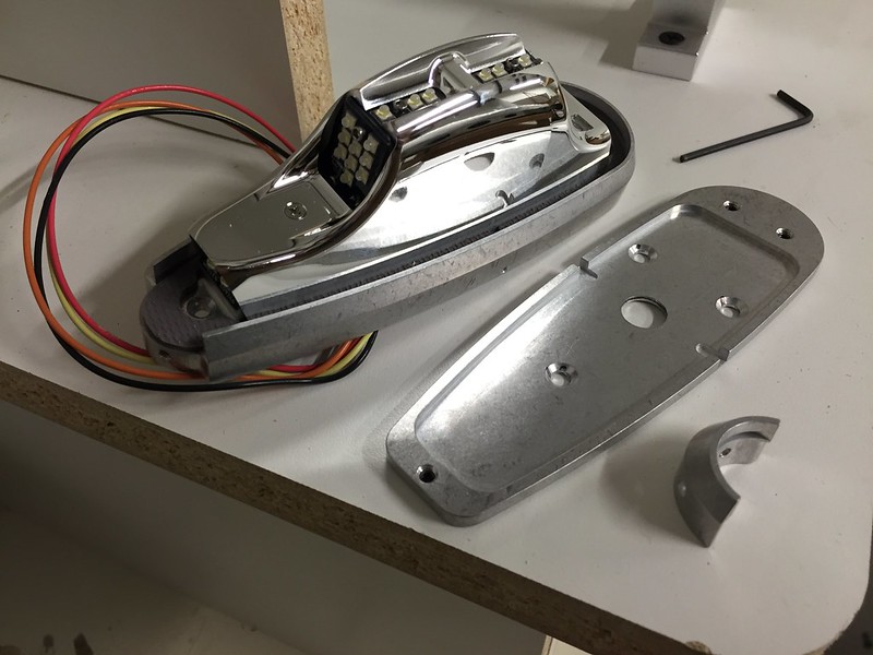

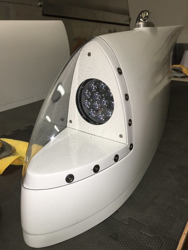

Lighting and other stuff...
I picked up all my lighting from Mike at Team Aerodynamics - new PAR38 sized leading edge mounting brackets, and four Whelen LED PAR38 lights (two landing, two taxi) as well as Whelen 600 LED wingtip nav/strobe/position lights. Great stuff. Also got a pair of fancier wingtips with landing light mounts built-in made by RMD (which was on my field here but closed in AUgust) and now manufactured by Knots2U. I have those same wingtips on my Cherokee, decided I liked them enough and wanted them on the -8A as well.

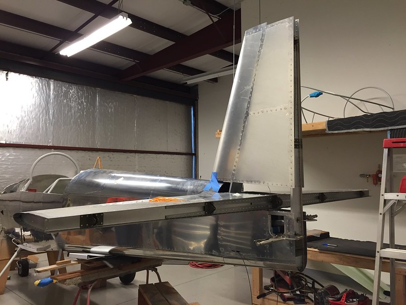

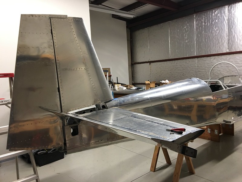

Back to empennage...

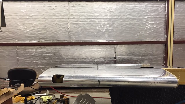

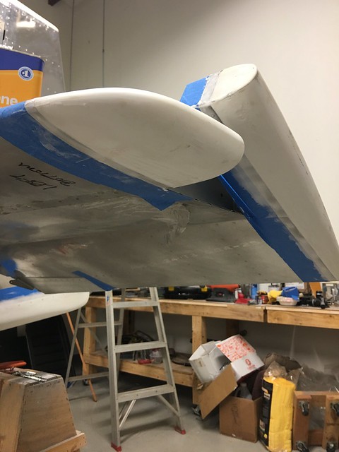

Recently most of the work has been on elevators and rudder and stabilizer hanging, fitting, etc. Just last night the tail feathers went on the fuselage for good (I hope hah).

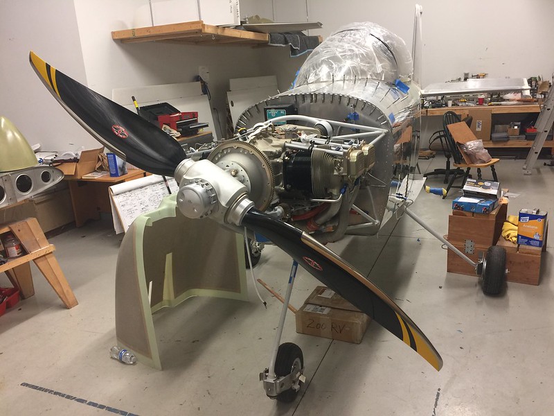

Actually, I just this week ordered a Whirl Wind Aviation 74RV constant-speed, two-blade prop. Pretty excited about that, did a lot of research and finally came to that decision. :)

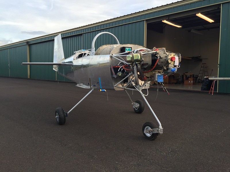

greghughespdx 08-18-2016 12:48 AM
It's been 10 months??
So, apparently I forgot to update this for about ten months. Time to catch up a bit, then.

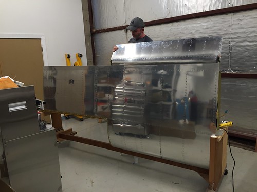

At last update I was working on installing the empennage and elevator assembly. Getting it all hooked up and moving happened shortly after, and was a motivation moment for sure. Whenever big pieced get added, and especially when you can move something somewhere on the project and something at the other ends moves as a result, well it just feels More Real. :)
Click for some video action:

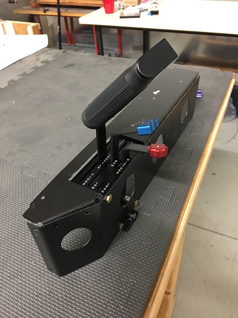

Made a small modification to the custom throttle quadrant.
Rob and Jeffrey over at Advanced Flight Systems surprised me with an email that essentially said, "Hey there, we have your RV-8 panel cut out and ready to install!" Well, that cemented that decision hah. The Hickmans and team are awesome. Great people and a great product. Their Quick Panels are laser cut and custom fit. This one will have a couple 10-inch 5600 touch screens and most likely an Avidyne 440.
Then things started to get a little, well, confusing and then complicated in the build process. More on that in the next post...

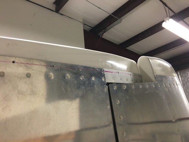

greghughespdx 08-18-2016 01:22 AM

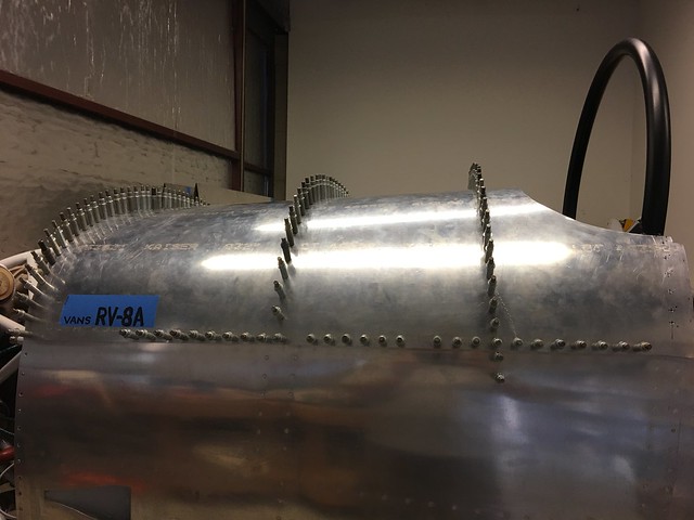

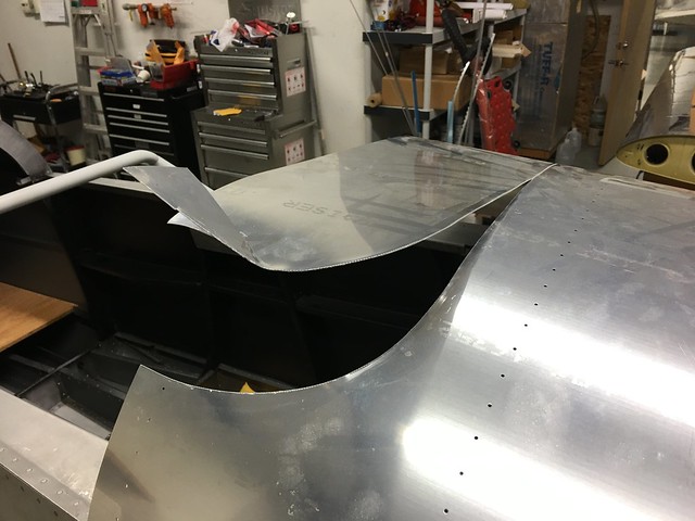

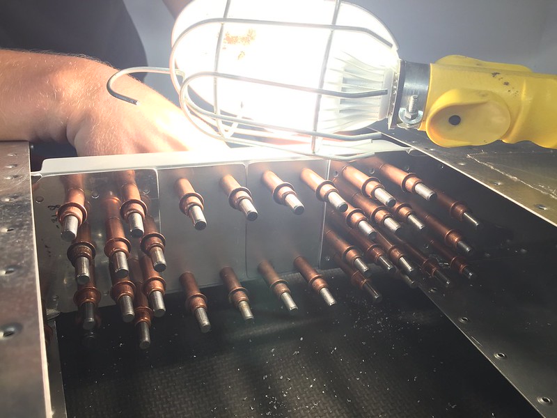

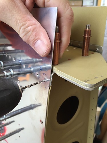

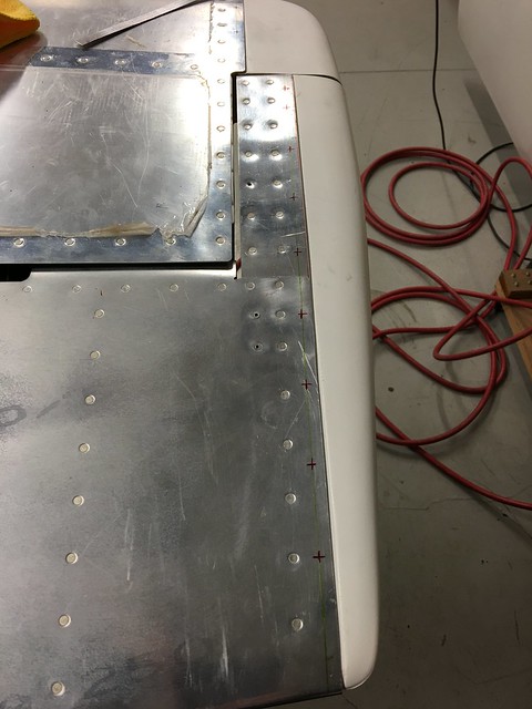

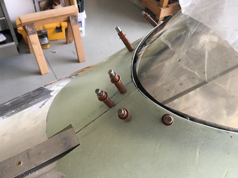

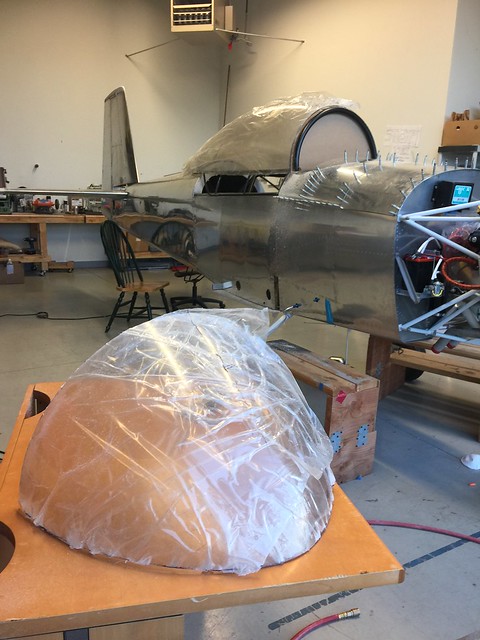

As I was fitting the top-forward fuselage skin, I found that things just were not lining up or fitting right. There were gaps and the instrument panel just wasn't fitting right (neither the Vans panel nor the AFS panel structure. In addition, when I did get the panel to fit and things to line up, the already-drilled holes were quickly getting to be a bit out of whack and mis-aligned...
It actually took a while to figure out what was up. In the end, it was a pretty simple issue (with a relatively complex fix). There are two strips of aluminum that are to be sandwiched between the upper forward skin and both the firewall bulkhead and the bulkhead that separates the baggage compartment from the avionics bay. Before I got the kit, the skin had been installed and the bulkheads match-drilled, without those spacers. Simple mistake and easy to make, but it meant I had to do some significant addition of materials and keeper rivets and additional holes, etc. to ensure a sound structure. The Vans staff was super helpful in validating the issue and resolution, and in encouraging me to work through some frustrating moments. I really like those guys. When I'd get frustrated with the situation, I just worked on something else. Eventually (emphasis on that word hah) everything was properly spaced, shimmed and reinforced. In reality, this was my biggest opportunity thus far in the project to figure out how to deal with something unexpected, difficult to figure out and frustrating -- and which really just had to be addressed. It ended up being a good learning (and character building, hah) experience in the end. I have an extra 6-8 ounces of metal in the plane as a result, but I believe I'll live. :)

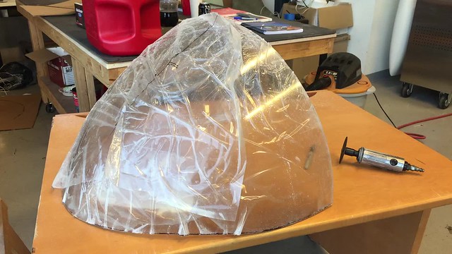

Cutting top forward skin:
Get frustrated? Switch to learning how to deal with fiberglass for a while, you'll feel so much better! :eek:
Click for video - really crappy initial fit

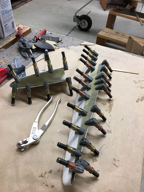

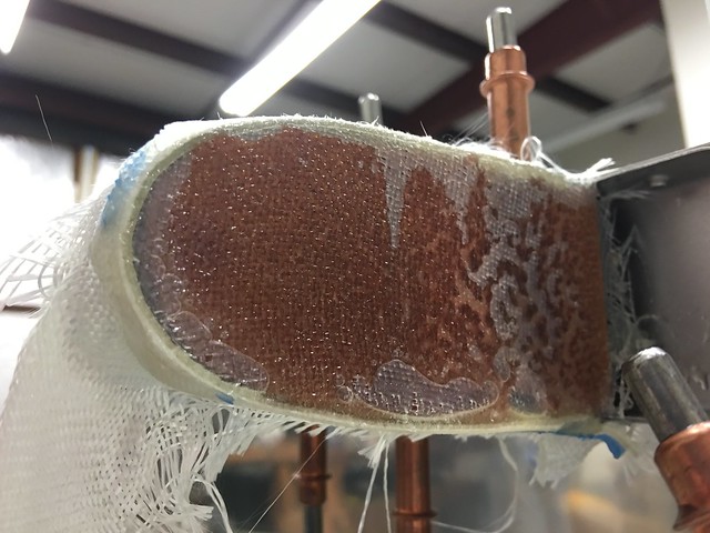

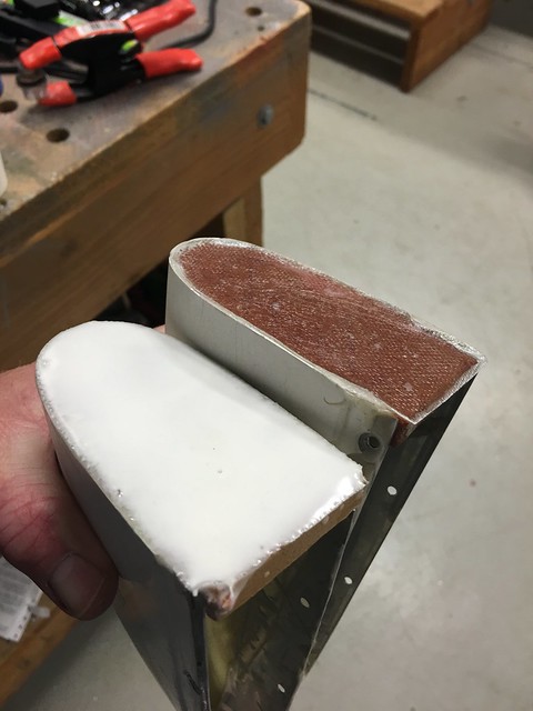

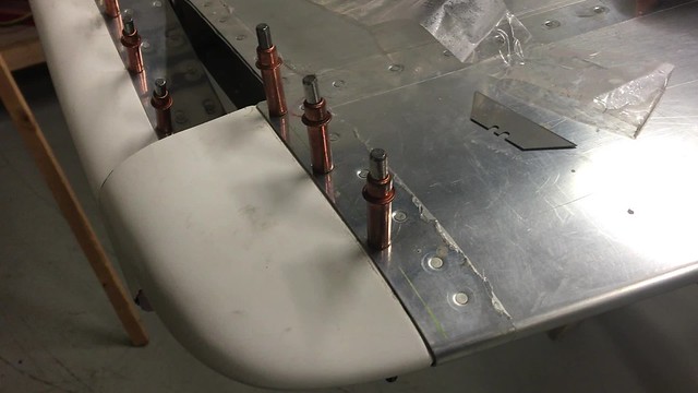

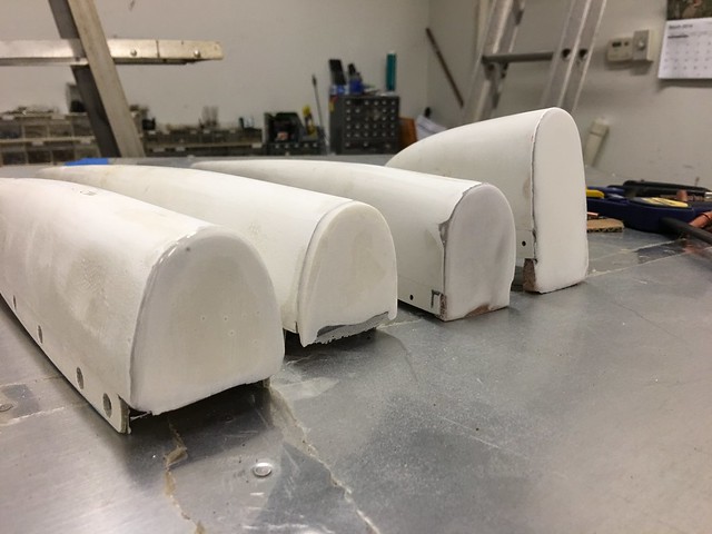

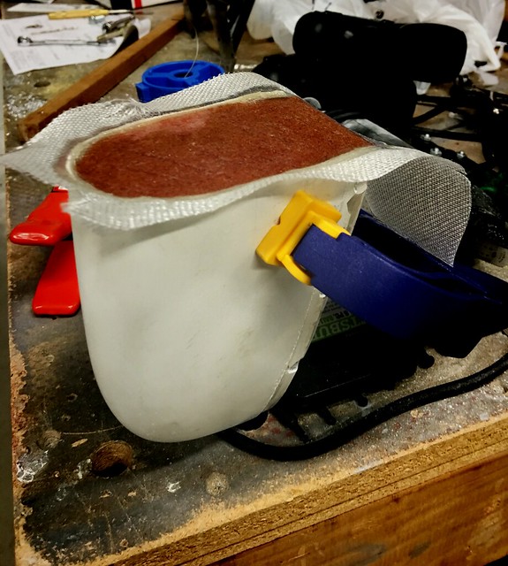

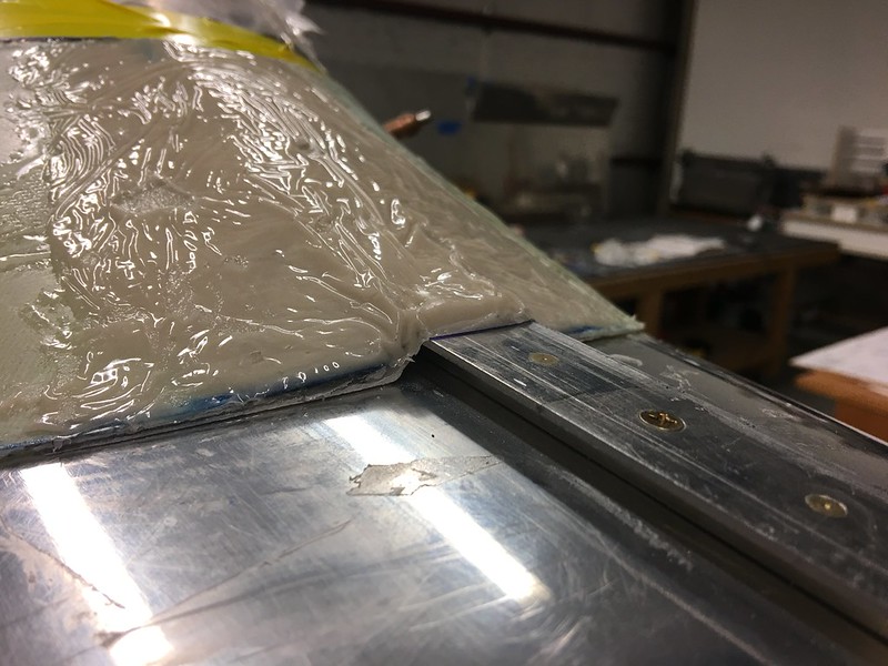

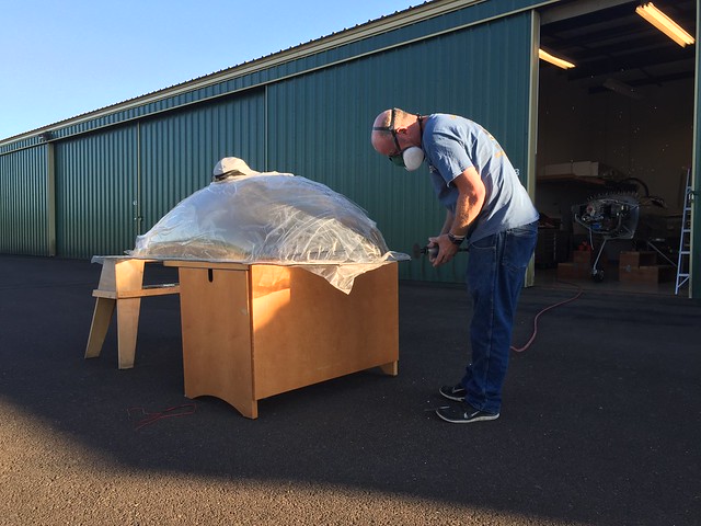

These tips were 16 years old when I started working with them. The fiberglass was hard and a little brittle. My approximate order of operations to fix them up was:heat gun for some significant reshaping of the warped tips, followed by foam inserts to help hold shape and provide something to lay up glass on top of, then glass fabric followed by a mix of micro and flox.
greghughespdx 08-18-2016 01:36 AM
In the early phases of learning/adjusting/glassing the tips they honestly looked like a pre-school art project. Looking back at the photos, I laugh. But in the end, not too bad.
Click for video:
I had to learn how not to do things, too. Hah. Some good learning. The nice thing about fiberglass is that if you screw it up you can just sand it off and try again. Well, for the most part.

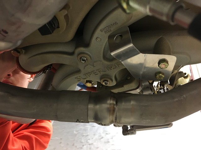

At some point, everything started to happen all at once, and in a phase of the project where lots of work results in little visual results. I think those are the phases that are hardest for me to stay motivated in. So I have to keep pushing through it and toss a couple cushion in there and pretend it's an airplane hah.

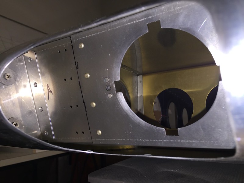

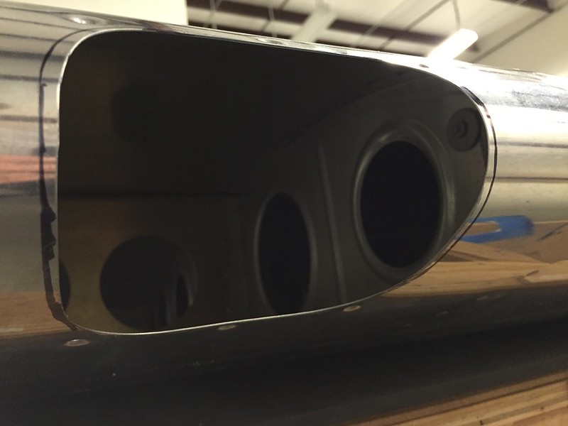

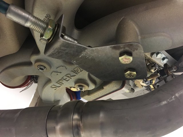

Discovered the Superior cold air sump doesn't have the same layout or geometry as a standard Lycoming sump, so the throttle cable bracket that comes with the standard kit won't work. Fabrication time. Aluminum first, then later made it up in steel.

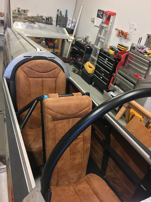

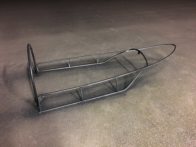

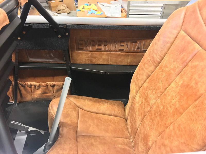

Decided my fancy (read: heavy) interior really requires black frames and weldments for the roll bar and whatnot. Found some tough automotive trim flat black paint that I like. Pretty tough stuff.

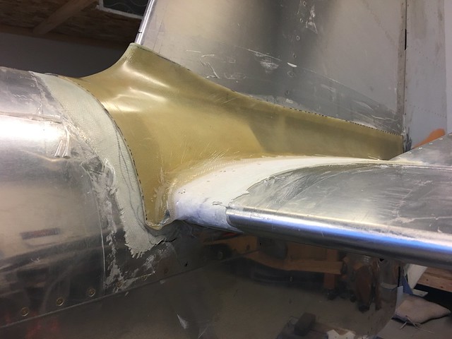

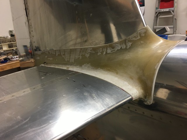

Took the long way around on the empennage fiberglass fairing. Learned a lot. Again. :)

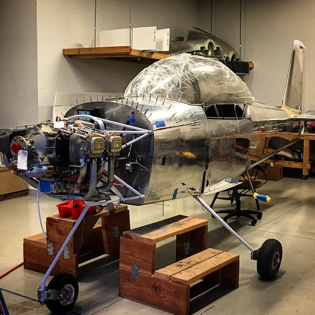

A break to make some airplane noises:

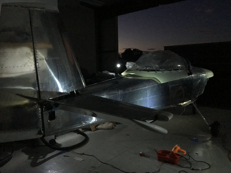

greghughespdx 08-18-2016 02:18 AM

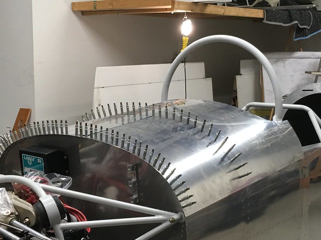

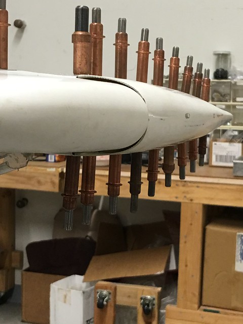

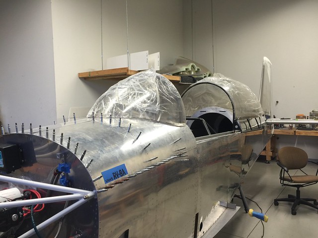

Finally getting all the top forward skin shim and spacers and whatnot in to address my earlier problems was a big deal. It took a while and in the end worked out just fine. This was actually just recently:
Nice thing was that getting that skin solidly and completely set lets me start on a number of other things.
After a few trim-fit-trim-fit sessions, seeing some good progress:
And honestly, for all the scary posts and worrying that I read online about this whole process and The Big Cut (important enough to get capital letters hah), it was basically a non-event. Warm weather, practice on the flange material for a while before you start, and use a good air tool and it's a piece of cake.
Video - click:
Honestly, I have a thousand more photos but that's at least some flavor of progress. All the pictures - good and bad - are maintained over on Flickr.
Lots of helpful and friendly people here at VAF, as well as locally and at Vans Aircraft, have made this a lot of fun so far. And I'd be truly remiss if I didn't shout out to Justin, who's in a few of the photos. He's a mechanical engineering student at Oregon State as well as a good friend and willing, talented builder/helper/doer. He and others make this project a lot of fun.
The prop is on order from Whirl Wind Aviation (it's a 74RV). The paint scheme and plan is pretty much set and colors determined thanks to some helpful people at the EAA headquarters who went well out of their way to get some color scans done for me. The interior is soon to arrive from the terrific Abby at Flightline Interiors. And the panel from AFS is also forthcoming, and I have their initial wiring harness sections to install now.

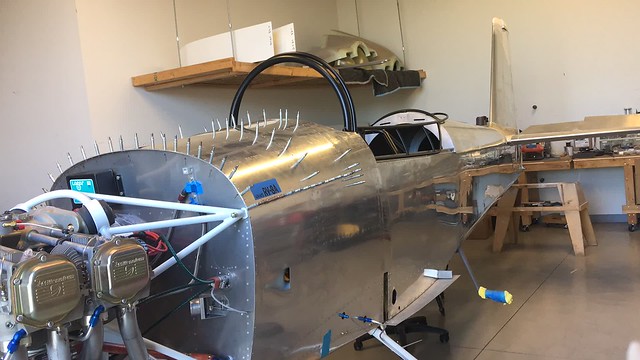

Bernie, thanks for the note - It made me realize I have once again failed to update here. :) I post a little more frequently at the Facebook page I set up for the build and lots of photos go on Flickr to help show the progress over time in a chronological order.

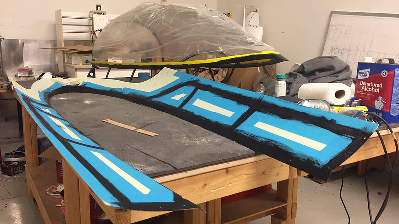

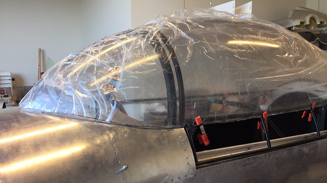

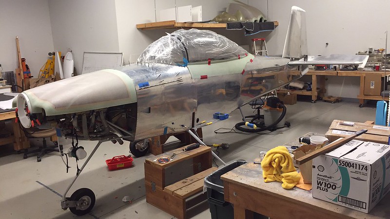

Work since the last update has been a bunch of canopy attachment and fitting, fiberglass skirt, started some wiring and panel stuff, fitting of the cowl started, autopilot servos and brackets just installed, some of the FWF and related connections have been done, and a ton of other small stuff that's often barely visible but takes a lot of time.
One highly-visible (and very comfortable) highlight of the late summer was receiving the interior seats and side panels, etc. from Abby at Flightline Interiors. She completely outdid herself, was awesome to work with, and I am super pleased with the results. Memory foam, heated seats, way too fancy really. Fancier than any furniture I have ever owned, hah. She deserves a mention, for sure. :) A couple pictures below, and video at this link.

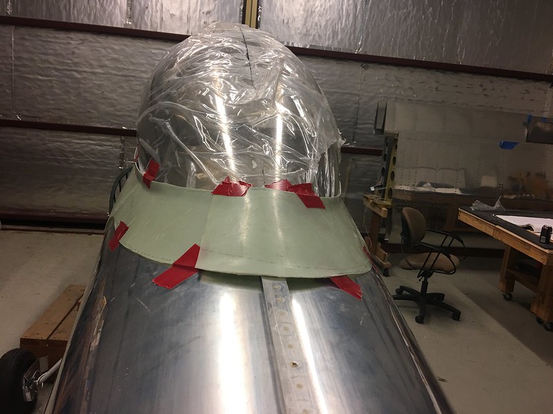

greghughespdx 12-12-2016 05:55 PM

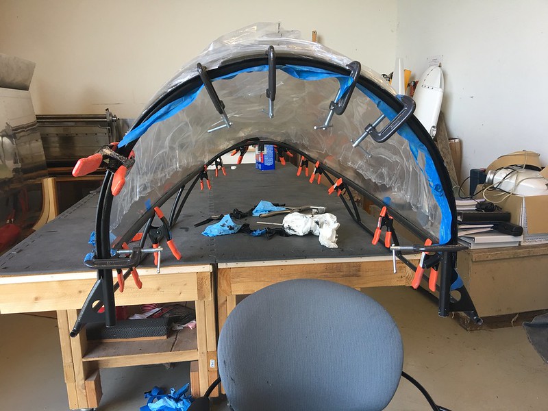

August: Gluing the canopy to the frame.
Death by Clamps:
Rough-fitting and refining the skirt:
greghughespdx 12-12-2016 06:08 PM
Working with sticky goop and teaching myself fiberglass tricks (the hard way).
Cha-CHING! (money well spent, beautiful prop)

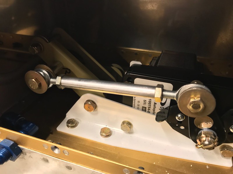

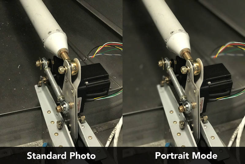

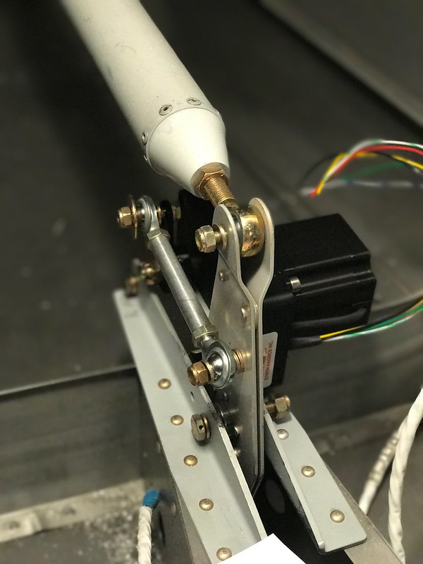

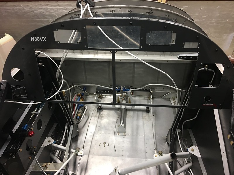

Started pulling some wires and painted panel structure back from the fine folks at Advanced Flight Systems (and yes you can fit two AFS 5600 screens plus radios and a dedicated autopilot panel in a RV-8 panel):
Autopilot servos going in. I tackled the wing servo while friend Justin squeezed into the tailcone for the pitch servo. Oh, to be 19 again...
Hundreds more photos on Flickr and the Facebook page, too!
