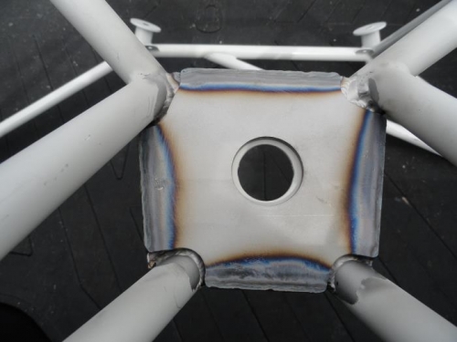

I have cracks and am currently applying the fix. I'm based on a grass field that is considered a bit rough but Bo's, a Commanche, a Travel Air(sp), and up until recently, a flight school operated off of it without obvious problems. I can count about 175 TO and Landings on my '10 since new.
When I went to inspect my nose gear mount I noted that I did have play in the assembly and that I hadn't checked this in previous condition inspections even though I had removed the wheel each time. I just didn't have it in my checklist.
Yes, I think it's important.
WOW!
I have not checked the landings, but can, but 175 landings is not many. I wonder how long ours had been cracked for? I suspect a long time.

MauleDriver 09-29-2014 12:35 PM
Originally Posted by RV10inOz (Post 918664)
WOW!
That was 175 landings and 175 takeoffs on the rough grass field. An equal number or more on hard surface. In my experience on my field, the nosewheel takes a bit of a beating on takeoffs as well as landings. No matter how agressively I get or keep the nosewheel up, it gets hit by irregularities in the runway surface
Though mine was cracked, it looks like it takes awhile. First the plate slowly deforms, then hairline cracks form (I had 2 hairline) and then the cracks slowly open up. Of course I didn't see this actually happen but that's what it looks like.
Looking at pics of a very badly cracked plate, my guess is that the damage will progress until the plate starts to break into pieces.
Again, I think the critical issue is the presence of play between the plate and the elastomers. I set it up once and never checked it again in 3 years. At year 2, I discovered a cracked nose wheel. I can say with certainty that my plane has never landed nose wheel first or otherwise experienced any trauma to the landing gear beyond operations on my home strip.

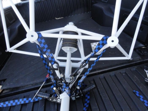

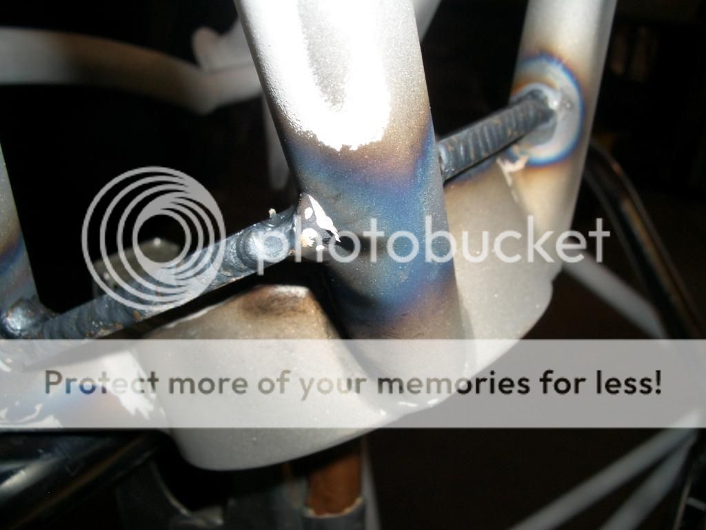

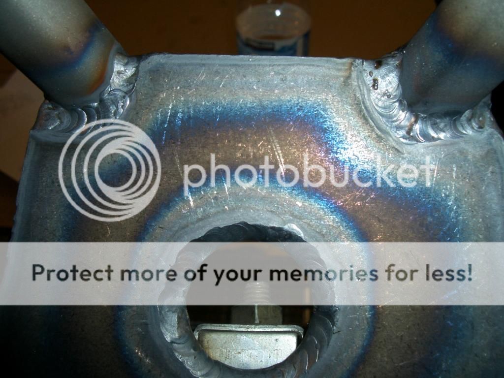

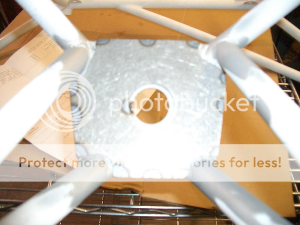

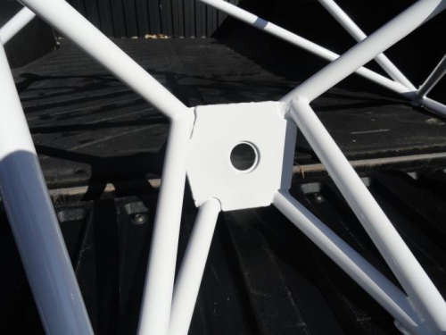

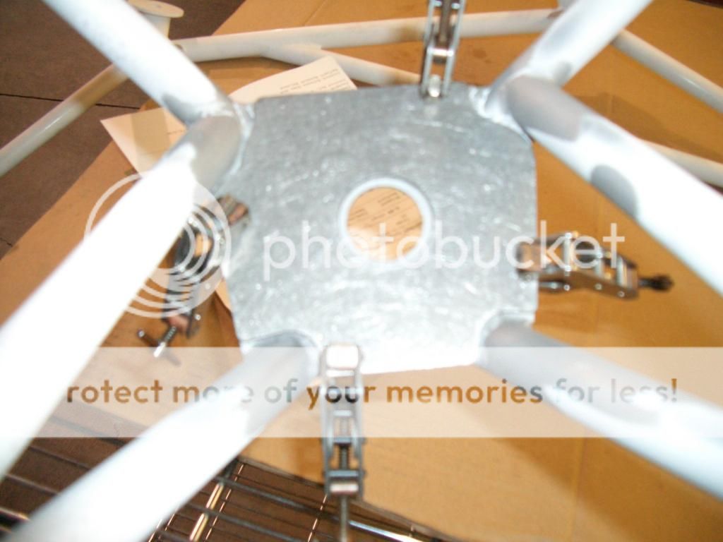

MauleDriver 10-05-2014 09:43 AM
My plate was cracked and I'm almost finished with the SB. Since finishing my project 3 years ago, I've been retired and maintaining my '10 as required.
I have <$100 spent on the work plus more hours of my own time than I care to count. It hasn't been fun work but I built the '10 to spend personal time in and on so I could possibly account for the time as income. ;)
I planned to start my condition inspection at the end of September and complete it by now but as soon as I saw the cracks, removal of the engine began.
Once the engine and mount were off and cleaned up, I called a neighbor who acted as my Tech Advisor during construction to inspect and advise. I knew he was an experienced aircraft welder and restorer and hoped he would offer to do the welding. He took the time to understand the SB and the job, explained to me how the frame and the plate had to be prepared and worked to ensure a high quality weld. I stripped the paint, did some grinding and otherwise got intimate with it all.
However my meticulous neighbor indicated that his TIG welder needed factory adjustment because "it wouldn't hold a steady spark". Instead, he suggested that another neighbor be engaged and told me that he would take the job over to him and tell him what needed to be done.
He did that and I went over to 'watch' the actual welding and to act as an intelligent work holder. The actual welding took 15-20 mins with the only glitch being contamination from the oil inside the frame.
The welder then suggested I have the whole mount blasted and powder coated by a guy up the road who does reasonable work. He then showed me an example of another engine mount.
It turned out to be Atlantic Refinishers of Creedmoor NC. I met the owner at the shop door and he said he'd do it in 3 days for $80 but he couldn't match my color. Gray would be fine.
I've reinstalled the mount, the nose gear and the engine using the old hardware and elastomers. None of it was broke, all was within service limits (2 washers), and all of it is easily replaced with new at any time.
So far it's cost me $80 + 2nd day air of the SB + cotter pins and a whole lot of not so enjoyable hours. I'm slow and careful but have to admit it is satisfying getting it back together. And maybe I've cured a persistent but unidentified minor oil leak(s) I've had since Phase 1. Heading back out in few minutes to do sensor wiring.
Some random notes:
The original problem is a small design oversight. Rough fields combined with play in the shock assembly slowly crack the assembly. My guess is that all installations will eventually crack without the SB though it may exceed the life of the aircraft. Keep the play out and apply the SB as writter, no problems.
Pulling the engine without detaching the mount to do the work could save some $$$ in contracted out work. For the home maintainer you are not saving anything and just making things more difficult IMHO.
An earlier experience with a second hanging of the engine suggested that keeping the prop mounted made rehanging the engine much more difficult. Impossible for me, but that may have just been me. It also may mean that keeping the engine attached to the mount for the SB work, and keeping the prop mounted, does in fact make things a bit easier but I don't know.

Update: Here is the mount after powder coat. Looks like it could have come from Van's this way. The cost to completely strip the part and re-coat it was about $220, but worth it for the piece of mind.
Update again: Here is how I reinstalled the nose gear with the mount off the airframe using ratcheting straps. Only the two short straps are showing but I also used two longer straps from the top mount points to the front of the gear leg. The longer straps had more leverage and did most of the work; using four was mostly to distribute the load and increase the safety factor should a strap fail.

Well guys, My 10 isn't finished so this repair was simple! Sandblasted the mount first, ground the plate to fit. Then clamped in the plate. I used to be a certified aerospace tig welder, so that part was easy! About 20 minutes of welding! The main suggestion I can make is that when you do this repair, remove the mount I've welded a ton of precision parts and I wouldn't be able to do a nice job of the welding if I couldn't lay it on my welding table. Second I suggest welding the entire plate so as not to leave any airspace between the plate and the existing mount- This would be an area of concern for corrosion! Finally a re-powder coat! I agree with others that glue, silicone, or other adhesive is not really suitable for a repair of this importance! Just my opinion! :D
M60Marty 11-14-2014 06:41 PM
Pics
Here are some pics of the process!
