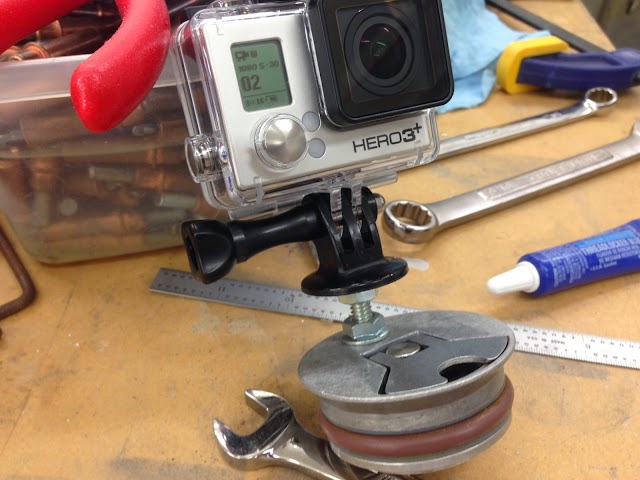

I've seen this so many times and thought I would give it a whirl. So I spent a few minutes in the shop with my spare fuel cap. We all travel with one, right? Picture worth a thousand words:

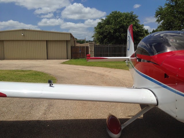

Looks like this on the airplane, was rotated about 40deg from straight on. Every change obviously requires a flight test, or two, or however many it takes, no matter how small. To our amazement, this configuration increased the clean stall speed (no flaps) by 12 knots! Our airplane stalls beautifully at about 52kts clean. With the camera there, it was stalling at 64kts! You could tell something wasn't right while slowing through 80kts. By 70kts it felt down right mushy. This is not what our RV feels like at all. Of course the first indication was the noticeably longer takeoff roll. The effect on stall speed with flaps down was far less. Maybe the -9 wing is very unique with the effect of this mount, but I've seen this setup so many times. Please be sure you really flight test it. Now, just as a thought exercise, I wonder just how long the mount stud would need to be to not have the huge adverse effect on stall characteristics? We're still amazed at the effect. Experiment carefully as I will continue to do :). |

Scott, I have wondered about how the camera would change the flight characteristics. If tiny little vortex generators can make as much of a difference that they do make, a camera bigger than all of them combined will for sure be felt.
I have seen many videos, including one posted today flying up the coast of Florida and no reported problems. I appreciate you reporting the issues you had. I am really interested in others experiences too. A month or so ago, someone posted a video of little strings all over his wings and how they changed in flight and what happened as they went into a stall. Maybe with that video a place could be found on the wing or other part of the plane that wouldn't cause an increase in stall speed. I am still building so I don't have the experience with the fuel caps other than the few times while doing the tanks to know how solid they are mounted. Is there a chance that the camera could cause the catch to fail and you end up with an open fuel tank? This will be interesting. Thanks for reporting what you experienced in your flight. I bet it was puzzling and took a bit of time to understand what was going on. |
The beauty of having a very proven airframe with which you have a perfect relationship for 7+yrs in the hands of pilots that are perfectly in tune with the exact expected performance of that airframe, to within a knot or two, is that it took no time at all to see that something significant was different. There was no puzzle to solve except for what just changed (obvious). Now how to get back on the ground with the most margin possible. Keep 'em coming, the percent performance change amazed my little brain. |
