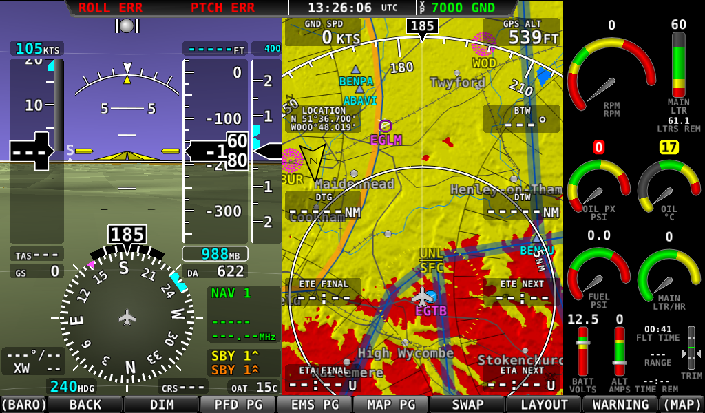

Mostly I fly the Skyview as 40%PFD, 40%MAP, 20%(Engine.) I did not like the standard Van's 20%EMS layout. Things didn't line up, some widgets horizontal and some vertical, sizing issues, etc. I rearranged mine as shown. All the widgets are vertical for an easier scan.
Oil Pres, Temp and Battery Volts/Amps on Top row.
Fuel Level, Pressure, and Flow, and Trim on second row.
CHT/EGT 3rd row.
Useful numbers at the top, with Stall and Spar Pins.
Post your arrangement!
Now, on the right hand side is something I am posting to the Dynon forum as a suggestion. For TAKEOFF and LANDING I like the 20% view. I like the context that the ranges provide. In CRUISE, I would really like a bigger PFD and Map but I do not like totally getting rid of the engine monitoring! This is a 5% wide strip (One-FOURTH the width of the standard one!) That would let the PFD and MAP both be 47.5% rather than 40%!
Note that the example is for a conventional RV with 2 fuel tanks and 4 CHT/EGT possibilities. Ignore the values of the numbers, this is a sizing-spacing example.
You can see all the numbers. I would add the coding of a green background when the number is in that part of the range (current widgets do not do that.) Comments are welcome on this too!
Oh - the pic on the left is not the STANDARD Van's 20% layout of instruments. I meant it is the standard 20% SIZE. The layout on it is my revision from Vans version.

Before you request that the numeric strip be horizontally across the top or bottom of the full Skyview screen, Dynon has said that would cause MASSIVE headaches with the paging and scaling code used for their current paradigm.
NASA515 04-12-2014 09:02 PM
Bill, why do you need all that EMS stuff on the small screen? I, personally, get goo-goo eyed looking at all that stuff.
I'm coming up on my Annual in two weeks and reconfiguring the EMS panels is high on my To-Do Lists.
I plan to get rid of almost everything. I don't need RPM and MAP. I figure it's one or the other. I don't need all that CHT and EGT stuff. And electric stuff. Why do you have that big Spar Pin light and callout looking you in the face all the time?. That duplicates the big red light by the key switch. I figure that's a pre-flight check - like once a year - without any annunciation required at all.
Why have the Stall warning light? Do you need that to tell when you're approaching a stall? What about the annoying aural warning? I can't remember all the stalls I've done and can't remember ever looking at, or even being aware of, the Stall light.
And on and on.
More and more, after pre-take-off checks, I get rid of the EMS screen altogether.
I'd like one or two parameters available as widgets on the Map display. That's all. Then, I'd deep-six the small EMS panel all together. If something starts acting badly, I'd call up one of the larger EMS screens to figure it out. The small screen is barely scannable on a routine basis. Too much info.

Good questions Bob!!! I have some initial reluctance to remove stuff that a lot of thought went into at Vans. I too can't figure out why the default layout (which I did not show) has a big gauge for manifold pressure - on a fixed pitch, normally aspirated carb engine. The stall light also can go, it's audible and I also have audible AOA. Spar pin, ditto - almost.... Vans layout had all these things.
But I like having the CHT-EGT temps. CHT would indicate a coolant problem. EGT shows problems even though we do not have a mixture knob. Gotta have volts, amps, fuel pressure, fuel flow, oil pres, temp, and trim. If I take off the items mentioned here as unneeded, then the is room for a few more info items. Fuel at waypoint, etc.

The Big Reveal
Here is what a full 47.5-47.5-5% screen would look like!
Leading up to the BIG REVEAL!
First a Standard 40-40-20 Screen
Then a Standard 50-50 Screen
Then a comparison of 40% vs 50% PFD
Then a comparison of 40% vs 50% MAP
Then a NEW 47.5%-47.5%-5% Display! Achieved by a tiny amount of cropping on the left and right sides of the 50% displays!!! Here they are:

If you like the 5% side bar, go to the Dynon forum link at the bottom of post number 11 and say you support it. Looks like they are considering it somewhat positively.
Bill_H 04-14-2014 11:28 PM
A very good suggestion on the Dynon Forum has resulted in this modification.
Green numbers when "in the green," not highlighted! Things on the screen should have prominence based on their importance, and abnormal situations should stand out much more than normal ones. So highlighting of Yellow and Red, no highlighting (or much more subtle highlighting) for normal (green)! Here's how that would look:

5 % Side Bar Gets My Vote!
I?ll start my comment by saying I have yet to order or install the Skyview in my RV-12 (not at that point yet) nor do I have any real time experience behind the SkyView with the exception of a demo flight at Oshkosh.
It has bothered me somewhat knowing that the EMS display takes up such a large amount or real estate on the SkyViews?s screen. I feel the 5% side bar, as post #15 depicts, is a very eloquent way to monitor EMS data and would be a much welcomed option on my future SkyView Touch. It gets my vote to be sure.
My added suggestion ? Should a value displayed on the 5% side bar be in the red (or perhaps yellow) I would like to see the ability of the new SkyView Touch to bring up the traditional ?arcs and bars? view by touching the questionable display value. Because we (or at least I) visually interpret the position of a needle on a gauge much quicker than a displayed numeric value.
Touch out of normal range value ? bring up the arcs and bars display - quickly visualize the full picture by seeing all the other EMS gauges - make assessment to determine just ?how bad? is it? Take appropriate action.

Only one problem, green numbers/letters are dark and against the dark background, they tend to washout in the sunlight, making them virtually unreadable.
Dynon has done a great job with their colors and struggles to provide good contrast. The good news is that as screen brightness and resolutions improve, these issues tend to go away.
Bill_H 04-15-2014 11:17 AM
Hacking - hmmmm - - - Dynon allows for a lot of layout user-customization on the Engine screens. Much less on the map screen - you can basically choose (from a list) the kinds of data blocks that appear around the edge.
Very little is allowed by Dynon to customize on the PFD screen. So the MAP and PFD would involve true hacking with all the risks of that. Particularly regarding what happens every 3 or 4 months when they do a new release level with new stuff on it. Kinda like jailbreaking an IPAD.
Bill R. - all of the depiction options require flight environment testing. Another idea was a much fainter less saturated green (think a light gray but greenish) background with black numbers. The green analog bar widgets actually have light green in the center getting darker towards the edge. So that light center green might be a better green background for black numbers.
On the Dynon forum discussions, a design desire expressed is that the 20% EMS screen would always be one touch or one button click away when using the 5% strip.
