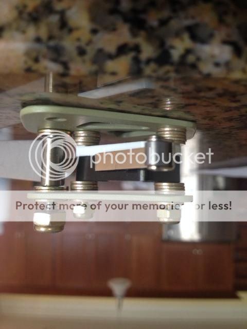

AN960-4L and AN960-4 are the washers called out on the RV-10 stall warning sub assembly which is identical to the RV-14 assembly. I think someone just took the 432 part of the number of the NAS number for the -4. I used the AN960-4 washers on mine.
Must be a typo...
