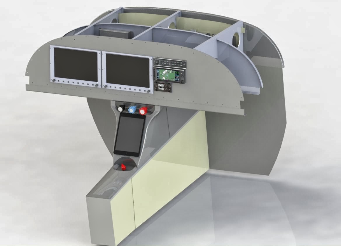

I found myself constantly wondering what to do about the instrument panel and all the avionics. The question constantly popped into my head and it was followed with more questions. Do I just build the upper forward fuselage section and worry about all the avionics later? Will it all fit? Do I want to buy or build a center console? Stock panel or expensive aftermarket panel? Layout? Install now or wait? etc...etc... So I decided to model the entire system to allow me to formulate a plan and resolve a lot of the questions and concerns I had.
So here is my plan...
This is the 3D model I created to show the aircraft structure and how I want to integrate my avionics; a Dynon Skyview system with a Vertical Power ECB and a Garmin GTN 635. I will be using Van's instrument panel and new fuel selector. I will be making the center console, side console closeout panel, and fuel valve enclosure. The center console mounts an iPad mini that is removable, and when removed reveals a small storage compartment for sunglasses etc. The instruments and avionics are shown below.

- There are mount angles attached to the ribs directly aft of the firewall. These angles are there to install the panels shown. The panels stand off the firewall 1.0in (no new holes in the firewall) and will be lined on the forward side with sound proofing. The other advantage to having the removable panels in this area is the avionics can be mounted to the panel, outside the aircraft, and then the panel screwed into place.
- The VP-X will be mounted on a plate that spans the instrument panel lower angle and sub panel lip. This allows easy access to the component for the large quantity of wiring that will be going to it.
- The ribs do not need to be modified. Only the subpanel will need to be modified to allow the GTN 635 installation.
- The Transceiver and Transponder are mounted directly to the existing tunnel cover side by side.
- The new center console will be made from fiberglass and can be relatively thin since the only thing that is installing to it is the iPad mini.
This is the plan for now...subsequent to change at any time : )
Any insight, comments, concerns, etc are welcome.

Cut out pieces of paper images to scale, scotch tape them to the real panel, put a seat cushion in the plane at the proper position, and see if you are happy with the "feel". e.g., Is it too long a reach to the GTN knobs? Does your arm block a critical view when you turn the knob? Another example, this is how I found out I wanted my efis lower (I wear bifocals).

One more thing. It seems like a long reach to your nav/com stack. Good advice in a previous post to make sure you're okay with the position before you cut any holes in the panel. Consider ergonomics like leaning against shoulder straps to reach the knobs, flying with your left hand, and how often you're going to be reaching over there for freq changes, etc.

I used SolidWorks to model everything. The model consists of about 70 separate components and is about 18mb in size. jwilbur PM me if interested in a few components in particular.
I plan on printing the hole thing to scale on our plotter and hanging it in the aircraft, followed by engine noises and pretend dog fights, to get a good feel for it all.

Nice job so far. However there are a couple things that catch my eye...
One thing that catches my eye right away is the location of the radio stack. It's pretty much over in front of the co-pilot (that right rib is about 24" right of pilot center, and is pretty close to centered on the co-pilot). Slightly offset is never an issue, but being that far over is a good ways from a comfortably usable position. It's a long way to read things, a long way to modify IFR fligthplans in the GPS, etc..
Next, I'd strongly suggest shying away from mounting any boxes on the firewall that you can put on the panel side of the sub-panel or on a shelf between the two. You can easily access stuff on the sub panel, but getting to stuff mounted on the firewall after the plane is done is more than a royal pain...I can guarantee you it will be, even with your mounting panels. For example, you still have to get the d-subs connected, screws tightened, etc.. All in poor light with pretty much one hand (or added clumsy use of the 2nd). Putting them on the sub panel means you simply remove one of those big honkin Dynon screens, reach through the now gaping hole with one or both hands while simply sitting in the seat. I can't stress enough how much easier this solution is over trying to crawl down under the panel. If it were me, I'd put everything in front of the Dynon screens, so that when me went to work on it I wouldn't be cussing at the builder! :)
Lastly and as others have mentioned (and I'll be my usual blunt self here), the GTN-635 is just a poor use of money in my opinion - especially when you can often get the 650 for the same price. Sure you may not think you'll "use" the ILS, but ILS aside out here in the boonies on the prairie, it's not uncommon for AWOS/HIWOS to be on a VOR freq, or at remote airports receiving transmissions for opening/closing a flightplan is on a VOR freq. Also, if you ever go to sell the plane I can guarantee someone will wonder "why the heck did he not just get the better box" and scratch their heads. Heck, even if you don't sell the plane people will still wonder! :)
I think you are off to a good start, I'd also just do a flat sheet panel and toss the stock Van's panel which will give you more vertical room to play with in the panel without costing much money at all.
