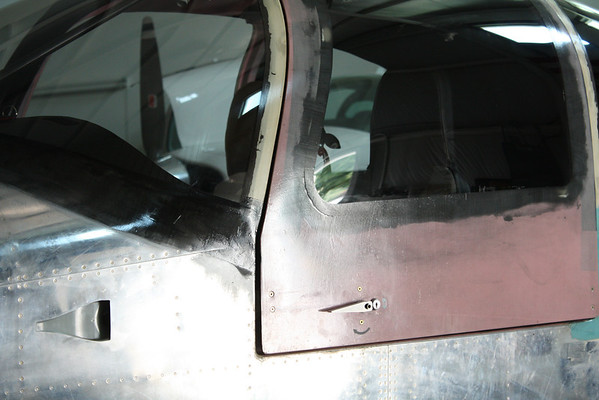

I don't know if you guys remember, but we attached the pilot side door window on our plane with Weld-On and the other windows with Lord Adhesive as a little experiment. Some builders feel that the Weld-On is responsible for the small cracks that form around the window over time. Personally, I was sold on ANY alternative after working with Weld-On for the first time; what a huge mess! Note that, for all windows, we left the appropriate (and same) size gap around them and then filled in this gap with filler as instructed in the plans.
Flash back to OSH 2012... at around 55 hours, a friend pointed out a "ridge" forming around our Weld-On window. It was pretty nasty looking and would have definitely caused some paint issues if the plane would have been painted already. Since then, this "ridge" has covered more ground around the window but has not really changed in height. Here's a photo of the Weld-On "ridge" when we first discovered it.

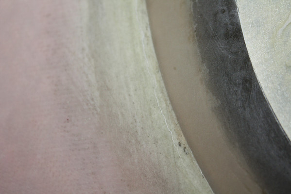

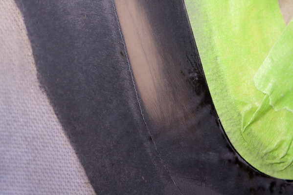

Yesterday, our painter, Don, pointed out some cracks around the rear windows and doors in which we had used the Lord Adhesive! Granted, they are NOWHERE near the size of the strange "ridge" that formed on the Weld-On window but, they're still there. We're now at about 270 hours and I've never noticed these cracks before so I don't know how long they've been there. They're pretty small so it isn't something that you'd see on an unpainted plane unless you were, say, prepping the cabin cover for paint. It might not even be something that would have shown up through paint already; I have no experience in this area. Below are photos of the cracks found in the Lord Adhesive rear and door windows, respectively. You can click them to open the full size image and get a better view of the cracks.
I find it very interesting that the cracked areas don't always occur at the edge of the window. A few spots are actually at the cabin cover, on the other side of the gap.
I still think Lord Adhesive is the better option but, it's not the ultimate solution. I'm not sure there is one short of masking the cracks by putting a few layers of glass around the seams. It seems cracks are inevitable when you have two different materials expanding and contracting at different rates. Anyways, just thought I would share more findings on our experiment.

Aerosport1 09-28-2013 07:31 PM
If no fiberglass is used over the joint it will crack no matter what it is glued with.
As Ivan said you need at least a total of 3 oz of cloth minimum. Also very important is to fill the gap between the window and the fiberglass top with epoxy and flox or fiberglass chopped glass as the filler between the two. The other
thing to watch for is if you fiberglass over the window joint you must not sand back thru it when blending it in to the cabin top. If you sand partially thru the let's say 4 oz cloth it will probably crack around the joint sometime.
The big advantage of the Lord adhesive is that it is a little stronger bond than the Weldon and much easier to use. It cleans up easier and is much more forgiving and a longer work time.

Aerosport1 10-08-2013 06:58 AM
I do have a small crack about 1.0" on the top of the wind shield. And it only cracked because I did sand almost all the way thru the glass cloth. I took the chance and decided not to repair it with fiberglass. It was more of a test than anything. You do not see it unless you are up on the wing. That being said if you sand thru the cloth or do not use enough glass or go without it will crack.
