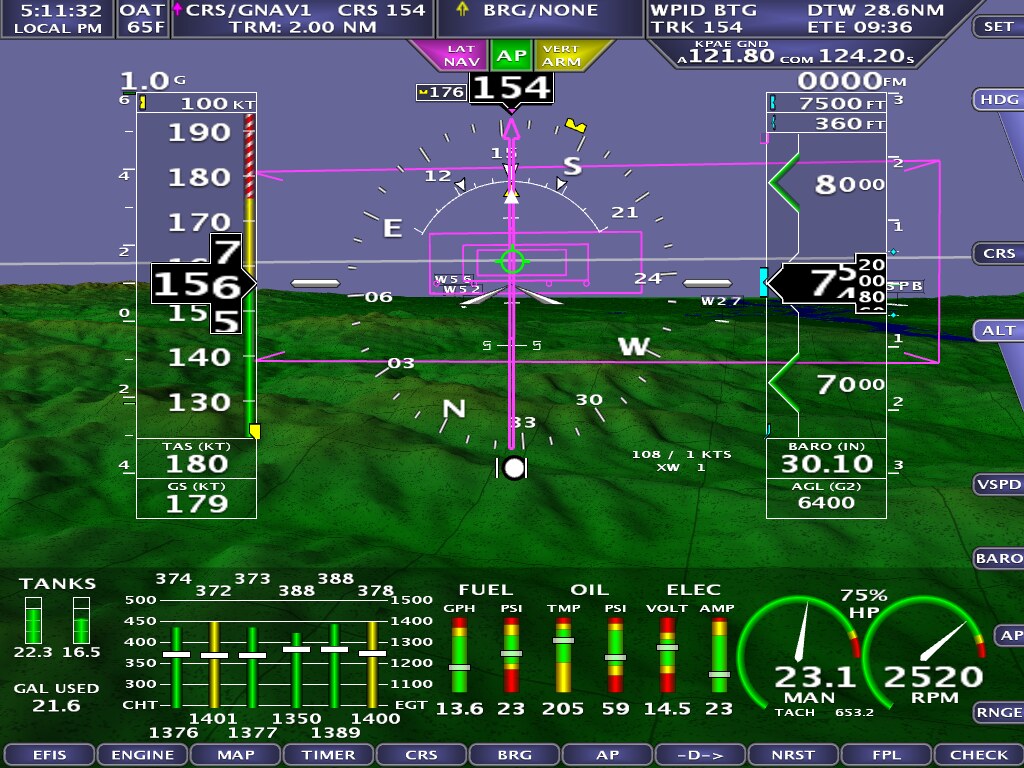

I recently made a 4 leg trip in my RV-10 with the Hartzell 3 Blade Prop and got a consistent 175KTAS + on all 4 legs at a weight of around 2400lbs.
Level at 7500ft and 180KTAS, this is an actual screen capture taken on a flight back from Dynon a few weeks ago.
At a fully loaded 2700 lbs it will slow down to around 165 KTAS. I have been told multiple times that it is the smoothest piston plane people have ever been in.
Rob Hickman
N402RH RV-10
