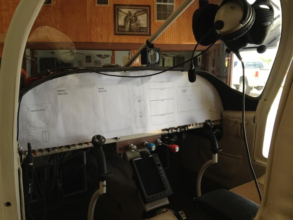

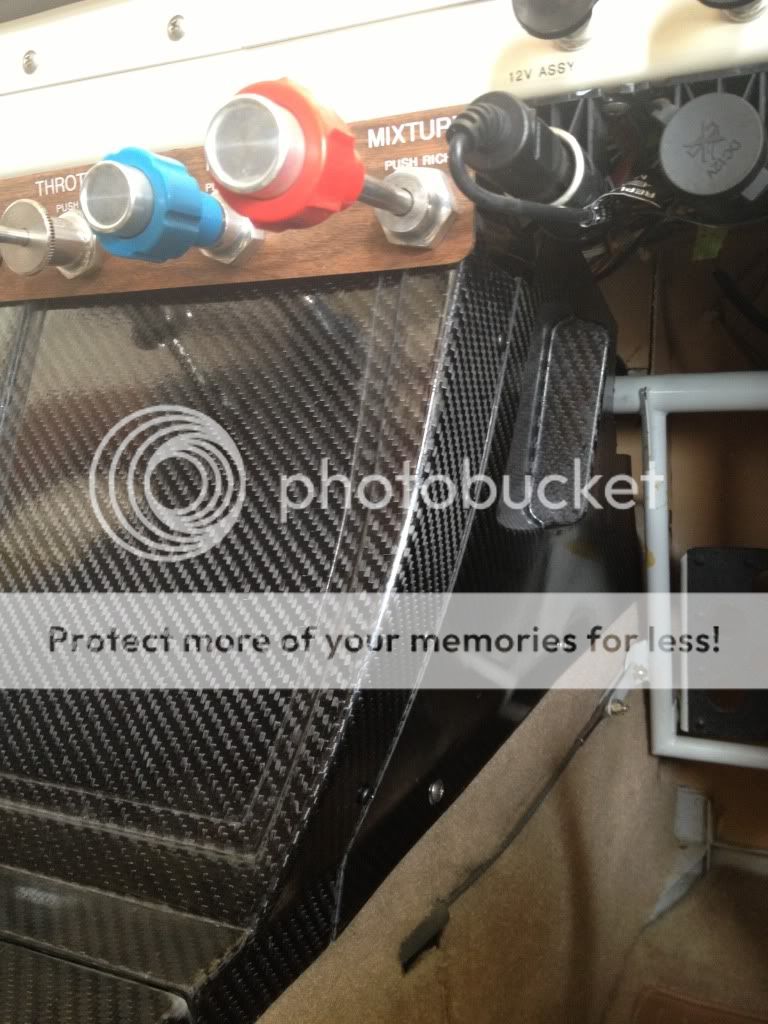

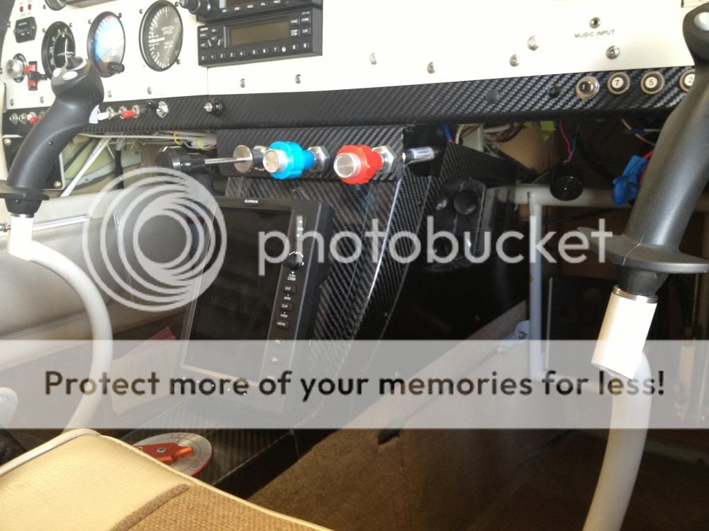

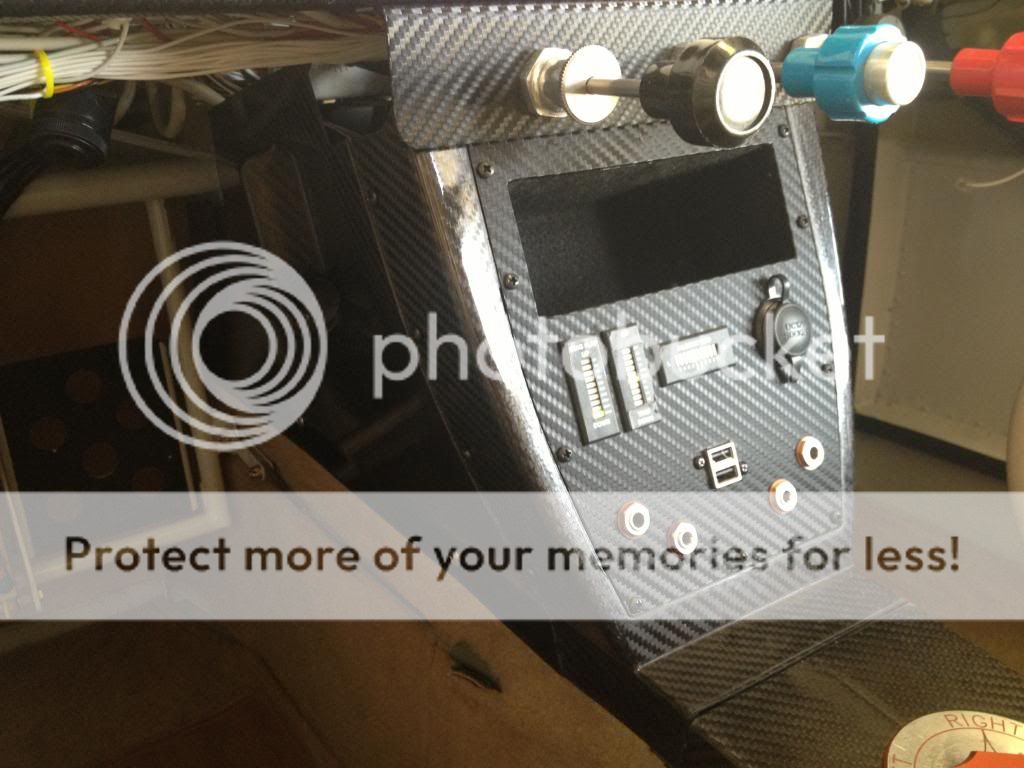

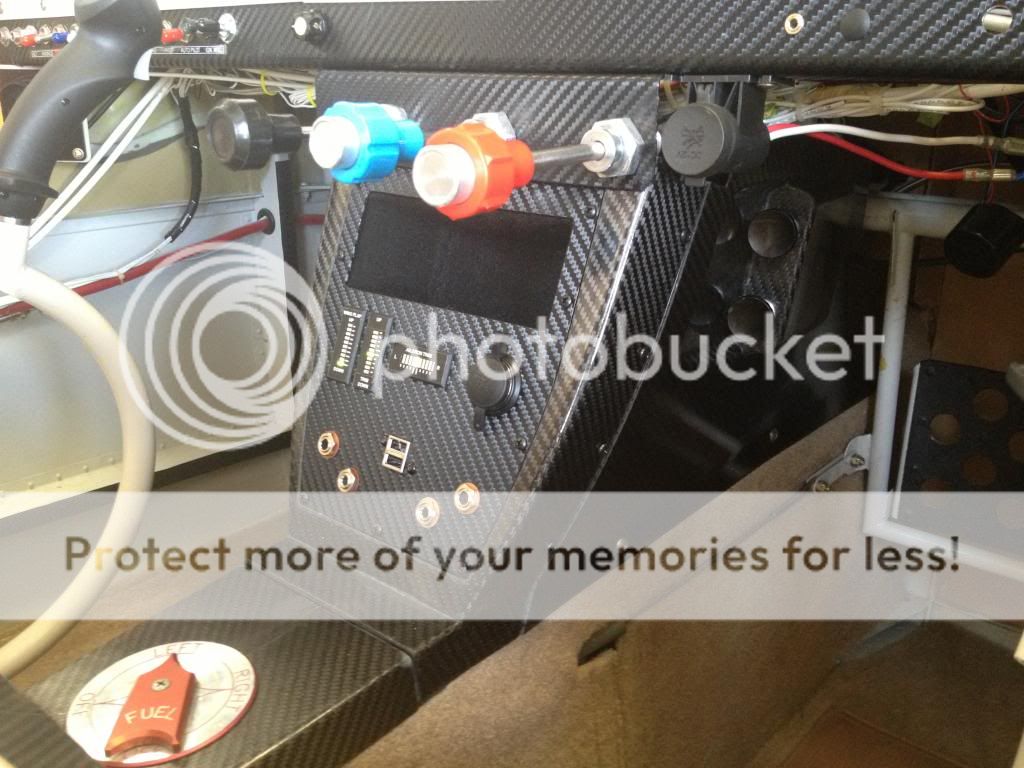

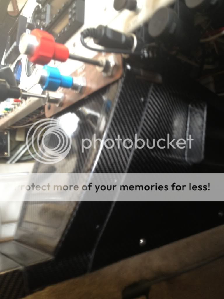

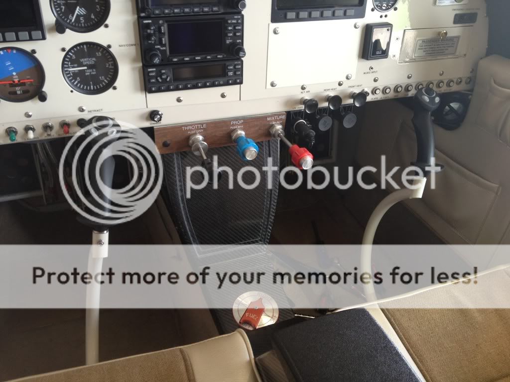

I could not find a thread on the combination of this setup. I am starting a panel upgrade and with time and cost a concern I didn't want to start completely over with and new Aerosport panel, but wanted the center console, and lower panel. It's not finished, but installed and functional.
If you look at the fuel selector you can see the modified location.
The center console is approximately 1.5" forward from intended, and I had to increase the angle of the lower panel by about 2 degrees. I am happy with the results, but plan to incorporate the stock Vans throttle mounting angle into the lower panel by moving it back about 1/8" for a smoother transition between the two. The Vans throttle mount is 1/4" wider than the Aerosport panel and centers up perfect.
Can't wait to get the new panel started.
Walt 06-17-2013 07:07 AM
Looks great Tim, one thing to keep in mind (holds true for building and mods) is easy access to the tunnel area for maintenance without major disassembly.
rleffler 06-17-2013 08:41 AM
As Walt suggests, I highly recommend installing an access panel on the side of the tunnel to make getting to the fuel filter and pump easier.
Another thing quite a few folks do is to cut the original tunnel cover near the fuel valve area. It makes it easier to take the rear tunnel cover off for conditionals.
Tim 8-A 06-17-2013 09:07 AM

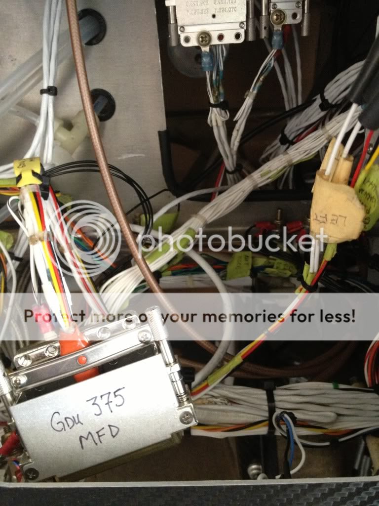

Good advise, 14 screws and all components are removable. I used existing tunnel nut plates so no additional screws. The panel itself will also be removable with the installed non essential indicators and charge stations. I plan to wire everything through either multiply connectors or one large connector. The heater pulls and alt air will move down to the side panels, I'm not sure how far they will move once unbolted but you will be able to gain access to the tunnel.

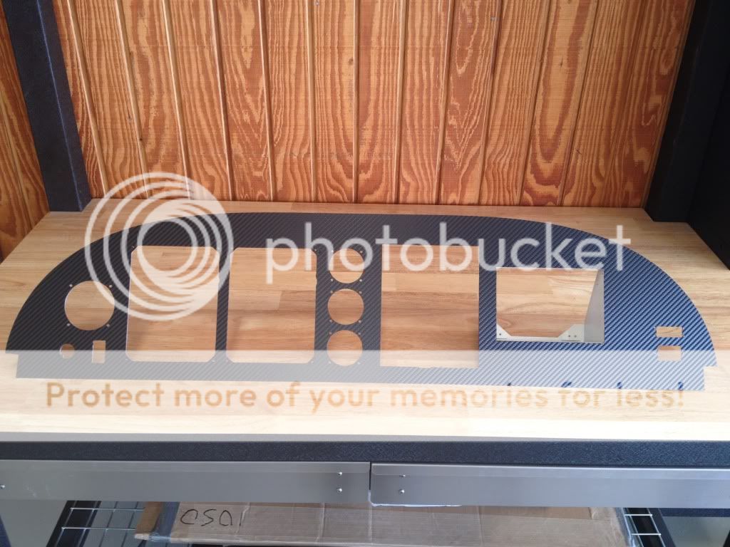

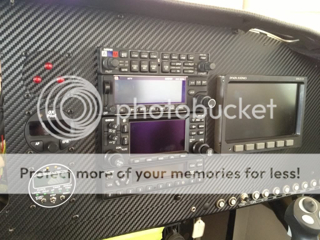

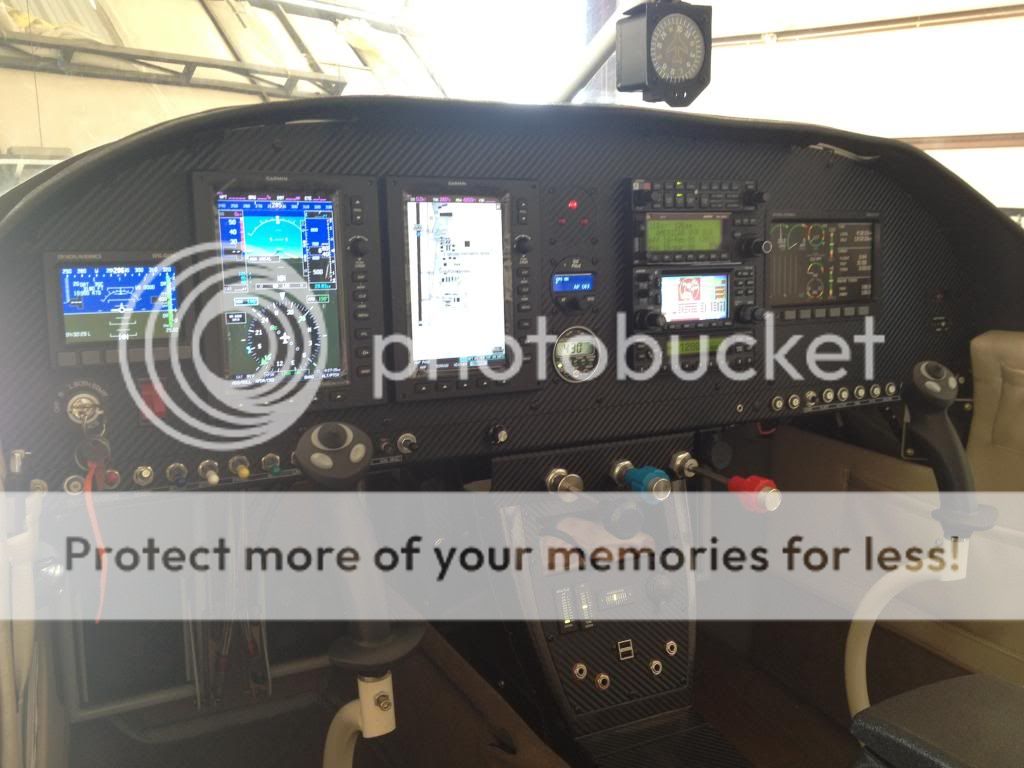

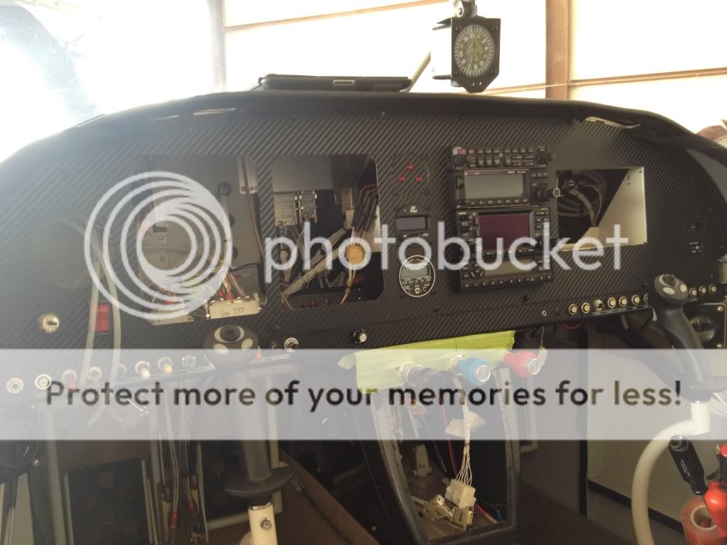

Tim 8-A 06-22-2013 05:56 PM

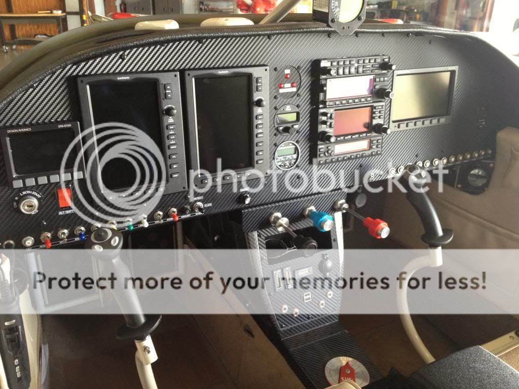

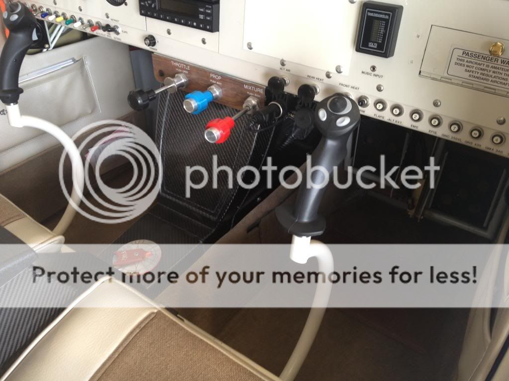

My plane is growing Carbon fiber!!
Making a little more progress on the panel upgrade.
I don't want the tan on the panel so without adding a third color I am going to try carbon fiber.
I think this is the best route without changing the entire interior color.
BTW the 696 is temporary until the G3X's go in.
Jesse 06-22-2013 08:03 PM
That's looking nice, Tim. Are you using the carbon fiber look sticker or some other setup? On the panel itself, are you going to angle the carbon stripes back the other direction? I notice your added carbon is not the same angle as your lower console. I think that'll look good to keep things alternating.
Btw, how's the hangar layout working out?
Tim 8-A 06-23-2013 06:36 AM
I using a 3M carbon fiber vinyl, that can be heated and stretched if needed, so far it's easy to work with but does scratch.
I ordered a 2 x 4 sheet and can't turn the pattern had a 50% chance of getting it right... oh well? It will look fine once I have the lower panel insert installed I will cover it with the same pattern direction, only the border will be opposite direction.
The hangar layout works perfect no plane movement to get the back one out.

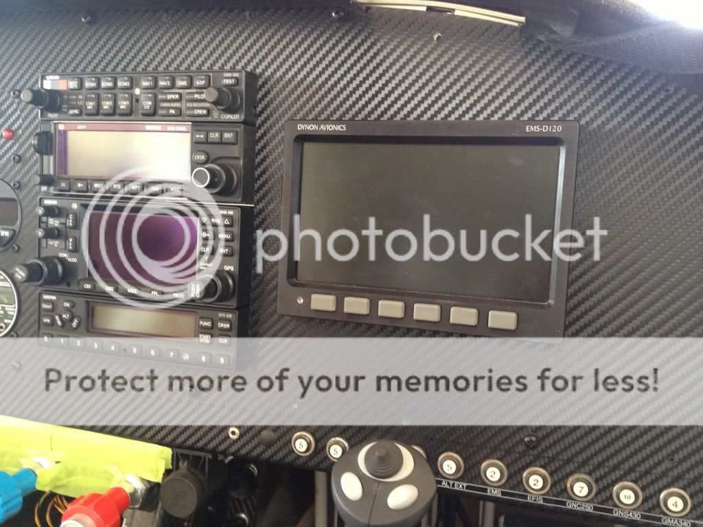

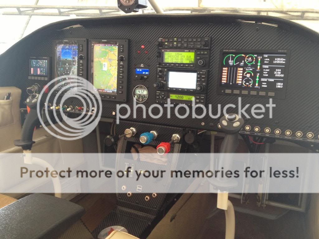

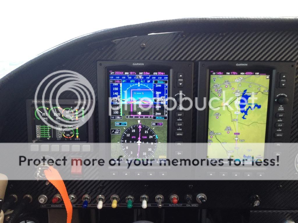

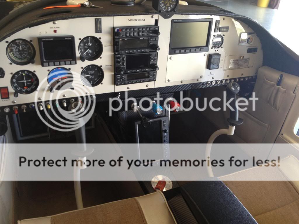

Tim 8-A 07-06-2013 04:39 PM

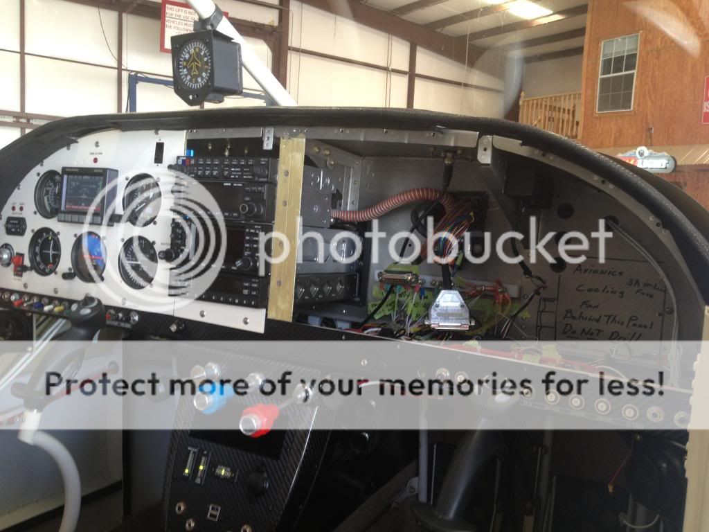

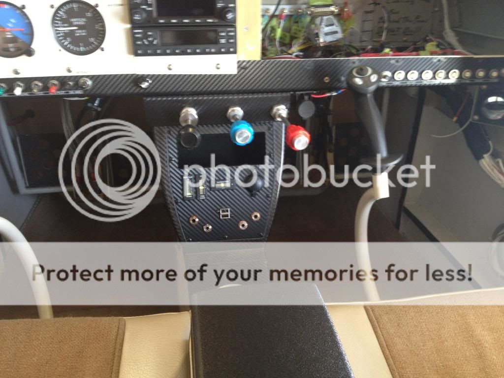

Well, after a few long days I have the lower panel wired and finished.
I am happy with the results, so far I like the carbon fiber the true test will be when the panel goes in.
The next step is the big one I have to take the plane down.
