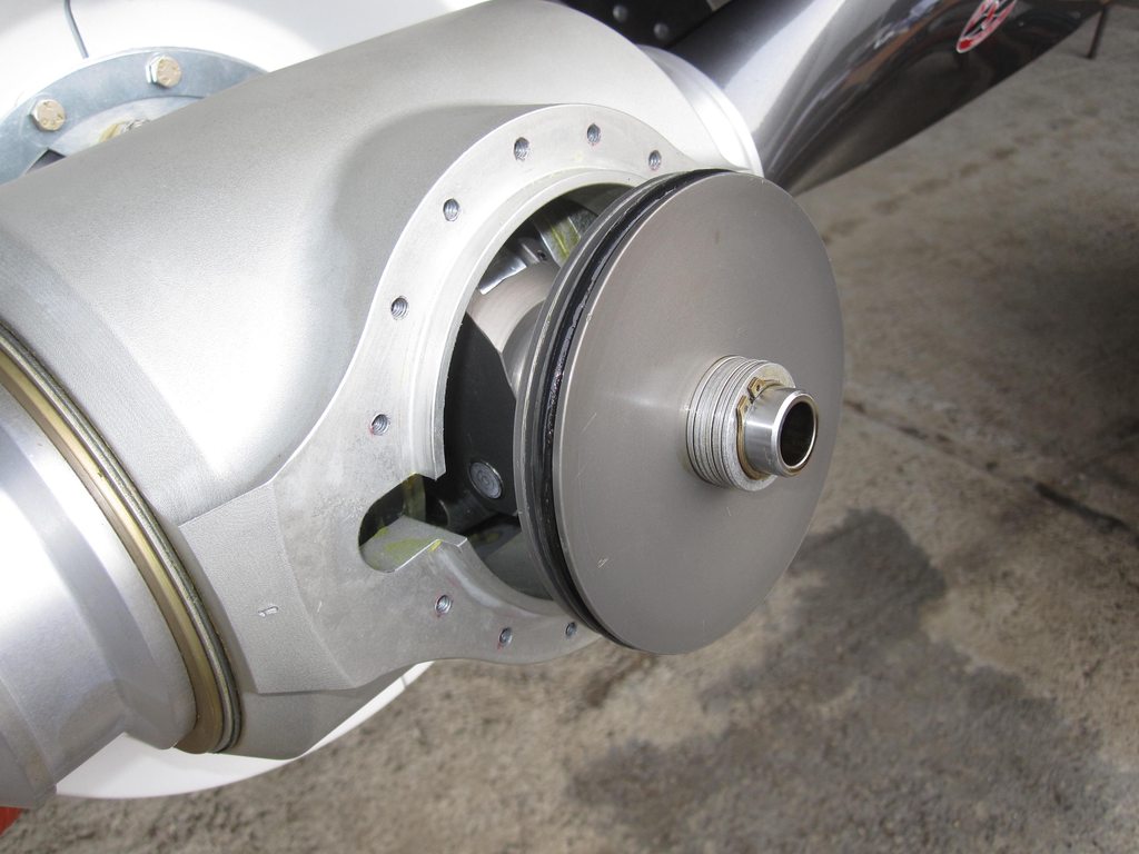

I wrote directions on how to to this last year when I adjusted mine. Let me know how these look.
PROPELLER GOVERNOR SETUP
  • Rotate the gov bezel to achieve full cable travel
  • Do a static ground run and adjust low angle stop to achieve a max RPM of 2550-2650
  • Fly the plane, initially taking off at less than max power to prevent overspeed. Check for max RPM on climb out, in cruise, and in a dive. If RPM exceeds 2700, adjust cockpit lever to hold 2700 and leave it there until on the ground.
  • Turn the low angle stop clockwise and keep testing until you can get 2700 max RPM in flight, and no more.
  • Adjust low angle stop to achieve the desired static RPM at takeoff, goal is to hit 2700 RPM as the tail lifts.
  • The governor arm throw may now need to be fine tuned to keep from slightly over-speeding. Fly the plane, and while in cruise adjust the lever to hit 2700 RPM and leave it there until on the ground. Now adjust the governor arm stop screw to match the prop lever position at the in-flight 2700 position.
  • Once adjusted, safety wire all bolts

You need to turn your low pitch stops CW IN, not out. It’s pretty obvious that your Governor is controlling your RPM right off the start.. that’s why you are getting a surge. Here’s what I would do if I were you.

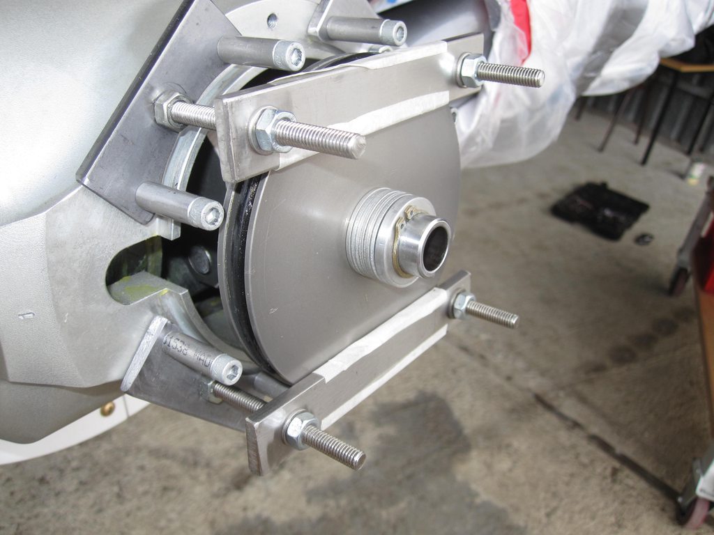

Remove the spinner, marking its clocking location with a dot from a sharpie.
Put an Alen key in the center screw, loosen the 9/16 nut and while holding the nut, turn the Alen key clockwise 2 full turns. Retighten the 9/16 nut.
Put the spinner back on before you run it again. It’s possible (I’ve heard) that you could damage the little fillet pieces behind the blades if you run it without the spinner supporting them from swinging out.
Raise your governed RPM to 2700 by backing out the screw on your governor one turn per 30 RPM. You should achieve 2700 on climb out at 100 knots.
