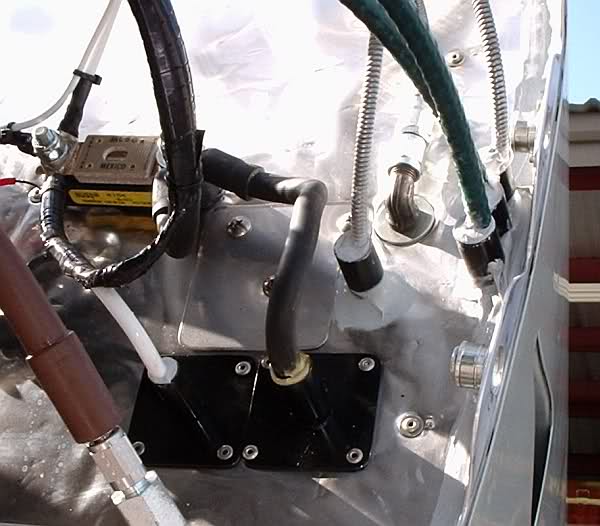

Bill, an aside...the firewall penetrations for control cables (circled) don't really need firesleeve. Just install the cable and pump the penetration full of FireBarrier. Gas tight and fireproof. It's not hard to cut the cured silicone if you ever need to replace the cable.
A penetration for wiring passage is a good candidate for firesleeve because it allows adding or removing wires. Those tend to be off to the side like the one in the foreground where they are not so exposed to fuel fire.

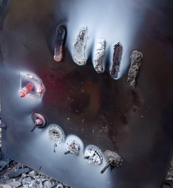

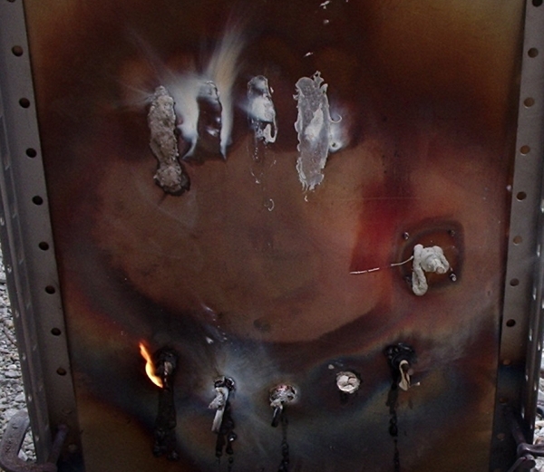

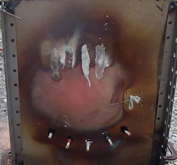

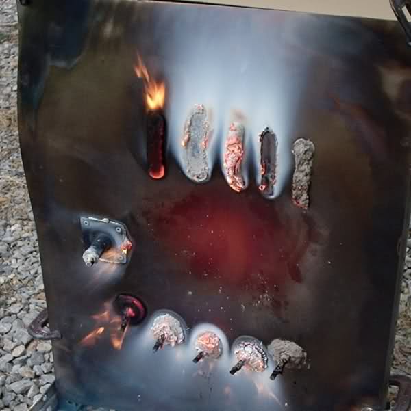

Insulation delays temperature rise. It doesn't stop it. The goal is to buy time, i.e. the ability to remain in control.
I don't think folks grasp how hot the firewall can get given an FAA-standard fire, even with an insulation package. The photo below is from a recent test, 0.060" 970 fiberfrax with 0.002" foil. The blue wires are thermocouples, with the temperatures displayed on the red meter. The black meter is the hot side thermocouple. The aluminum angle on the back side of the "firewall" has passed 400F at 1:30 into the run, so if painted, it would be generating smoke. Temperature will rise to 750 or so in 10 minutes.
The real goal is the second number on the red meter. It's the black heat target 6" aft of the firewall, a proxy for the soles of your shoes.

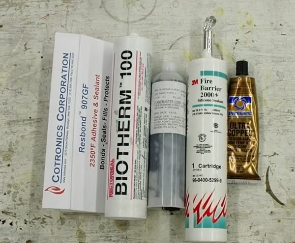

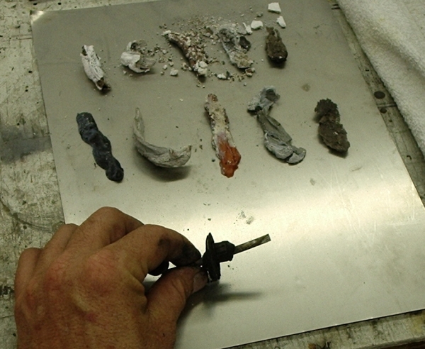

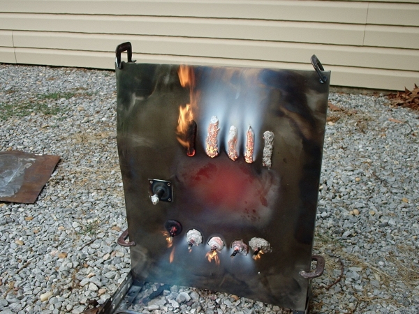

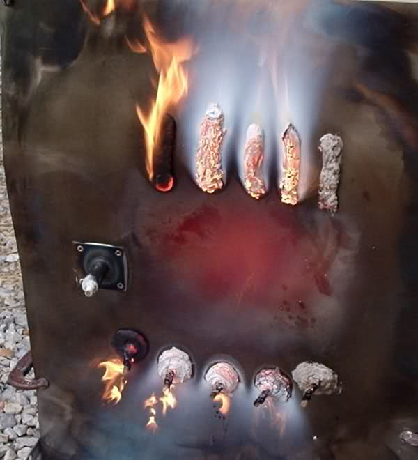

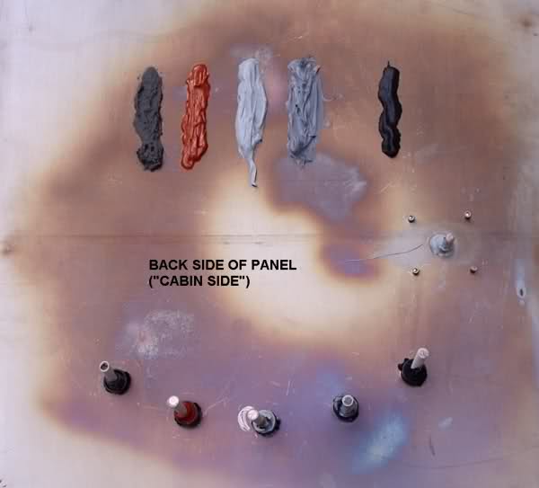

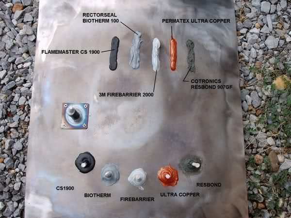

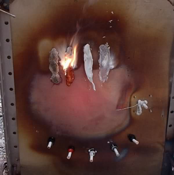

The cured Shore A hardness is very low at 20, half that of 3M Firebarrier 2000+. The SDS doesn't mention calcium carbonate, a major ingredient in the 3M product. I think the mechanism is the release of CO2 for fire suppression during decomposition, but I'm no chemistry guy. I note a caution regard oils.
I happen to have some test sealants in process and hope to report more later. Unfortunately the Sika product isn't one of them. My reliance on the FireBarrier 2000+ product is partially based on flying it 12 years in an engine compartment.

At those prices you might shop for some Dapco 2100, the advantage being known level of oil resistance.

Well, that's what I'm talking about...temps in excess of 400F. An insulated firewall in normal operation is just bare toes warm. I'm not kidding. I've been kicking my shoes off and sticking my feet through the rudder pedals for years now...

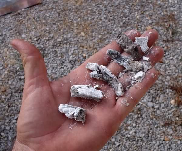

A detail worth noting...
The standard brake fluid reservoir is a welded aluminum tank with an outlet nipple extending through the firewall. The plans call for a nylon fitting screwed in the nipple, then nylon lines run to the brake masters.
The photo below suggests an aluminum can with a nylon nipple might not be such a good idea. In this case the can got hot due to an engine compartment fire on the ground. Aluminum is a terrific conductor of heat, so not surprisingly, heating the can melted the nylon fitting, which then released the brake fluid into the cockpit. Kindly recall brake fluid is flammable, 83282 a bit less so (450F flash point) than 5056 (250F). Not that it matters. The nylon didn't melt until about 490F, so the fluid there is already at the flash point.
What we have here is a fire transfer device.
So what to do? The reservoir below is encased in a simple 0.016" stainless shield. There is a 1/16" insulation liner, and it's sealed with FireBarrier 2000+. It will preferably get a steel fitting on the cabin side, but I would not have any concern for an aluminum fitting, because it's not going to get hot enough to be a concern, given both the can and the firewall itself are insulated on the hot side. Plumbing will be steel braided nylon, not bare nyloseal or similar.
Let's build better airplanes...
