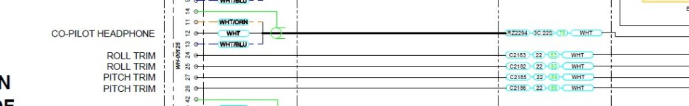

I have a question about the GSA28 autopilot servos. Based on the information above about them only being able to accept 20 AWG wires, I'm having trouble figuring out how to properly wire them. I see that they can pull a maximum of 2.8 amps. It would seem that a 3A fuse would be pretty risky, so you could use a 5A fuse for just one servo. But the wiring runs are pretty long -- I'm estimating about 15ft from the panel to each servo. 5A for 15ft comes up as 18AWG per the official FAA chart. It doesn't use 2.8amps continuously, but I have to match the wire size to the fuse, right?
Kirk, on the -14 WH-00125 wiring schematic & harness, Van's is using 18AWG for the AP servos.
Here is the wiring diagram for the GSA 28 as presented by Vans. For the trim wires it does switch to 22 awg at the wing root but the main power stays 18 awg.

Well, now I'm confused -- I concur that 18AWG is an appropriate size, and what Van's specifies in the -14. But I double-checked the G3X Touch Installation Manual (Rev AU, page 1-8) and it says 20-24AWG for the GSA 28 connector. So I wonder how people are connecting that 18AWG wire to the GSA 28? Perhaps @g3xpert can help?
My interconnect drawing {from Stein) shows 20 awg wiring. Note: Stein also produces the WH00125 harness. Probably all about voltage drop and allowable risk tolerances.

I’m thankful for this discussion. I used 22 ga for the A/P wiring, looks like I need to upsize to 20, missed that. The Ray Allen servos say 800 mA max so assuming 2 GSA 28 servos plus 2 trim actuators is 5.6 A max/peak. AC 43.13-1B Fig 11-3 says 20 ga is good for 20 ft intermittent at 5A. If you want to use 18 ga for most of the run that’s fine but I would leave the CB at 5 A like Garmin recommends. You can use Raychem environmental splices or PIDG butt splices to get back down to 20 at the DSUB connectors.
-Bob
GSA28 specs. Below.
Two seat RV controls are very light, low torque = low current. (Torque = 30% typically)
Even the “heavies” use less than 50% torque so current draw is certainly closer to the ‘‘typical’ value.
18ga is overkill, 20ga good, 22ga should also be fine.

Also, no real reason to not use 20 AWG instead of 22 AWG. 20 AWG makes things simpler and it is easier to work with than 22 AWG.

20AWG is fine for the servos. 2.8A is max servo load plus max trim motor load simultaneously. Which would be extremely unlikely and very short duration anyway. Even the max servo load of 1.8A as Walt says would be highly unusual in an RV.
The 18AWG wire carries two or three servos if you wire all three on the same circuit.
Good point Stein used 20 awg for the 3 servo's on mine and Van's used 18 awg for 2 with an option to add a yaw servo. Stein had a 5-amp fuse protecting the circuit.

Am I missing something? Bus 1 sees alternator 1 output but no connection to Bat 1. Bat 1 can cross feed Bus 2, but no connection to Bus 1. Can’t run stuff with just the alternator.
Yes, I realized that mistake after I posted it -- there is now a connection from Bat 1 to Bus 1.
Are you open to sharing your drawio file(s)/symbol library?
I just used the standard library in draw.io but had to hand-craft a few things. Message me your email and I'm happy to share.
A clearance bus makes no sense to me. Treat each as independent avionics buses.
I have had some pretty long clearance delays -- by having the equipment needed to get clearance all on one bus, I can leave the other bus (and the engine) off while waiting. For example, I was recently in the NYC area and I was running for almost 30min waiting on clearance before I moved the plane. My Bus 2 has 20-60min of runtime without the engine running. In that scenario I don't like the idea that I could be down to less than half of my battery before starting the engine. My Bus 1 has 30-80min of runtime.
The cross tie would only (possibly) be utilized for starting.
Only one ADAHRS but it is labeled #2. No real worries as your G5 is the defacto "other" ADAHRS. Sorry, didn.t see #1ADAHRS. Second one is well into diminished returns with a G5 installed
What is your reasoning the ADAHRS IS NOT powered from each bus?
With two ADAHRS I figured it is better to separate them just in case there was some sort of crazy electrical event on only one bus. The redundant power isn't necessary and adds just a tiny bit more risk in my opinion. Also it saves me two fuses to not have both ADAHRS on both busses.
I'm not dead set on having two ADAHRS, but the cost is also (relatively) low. I like the fact that the avionics can alert me on disagreement between the ADAHRS systems, and then having the G5 as the tie breaker.
Ditto G5?
Ditto GAD 29?
G5: Kind of like the ADAHRS, with the 4-hour internal battery the redundant power connection seems completely unnecessary, and introduces a tiny bit of risk if either of the busses have a very high voltage event, for example. I guess also it will add a bit of drain to my Bus 1 battery during clearance delivery.
GAD 29: figured I don't need dual power since it doesn't appear to have any function if the GTN 650Xi is offline. So I figured I would want both the GAD 29 and the GTN on the same bus (and only that one bus).
Will the dedicated G5 BU battery bring real value with four other wattage sources (assuming dual feed from each bus. See above
If there is ever a fire situation, electrical smell, etc, and I'm not in heavy IMC, I will turn off both busses (which includes the batteries and alternators) and land with my G5, handheld radio, and/or Foreflight.
- Your Pmags (or any EI or EFI) should be connected directly to the battery. You want as few appurtenances between the wattage source and vital equipment as possible. Having them on the same bus makes little sense to me. Reference previous assumption.
I have pMag 1 on Bus 1 and pMag 2 on Bus 2. Considering the pMags can also generate their internal power, I would need both electrical busses and both pMags to fail before I lose my engine. That's why I don't have them directly on the batteries but I could be convinced otherwise. I figured it was safest to be able to fully turn off all power with the main Bus 1 and Bus 2 switches.
- The DPST switches for main bus relay control make no sense to me. Without independent control of the battery and "related" alt, there's no way to utilize the "other" alt e.g. an alt drops off-line and/or you need to isolate it, you've lost that battery wattage as well which defeats that redundancy..
This one I have gone back and forth on (in my head of course). What may not be obvious is I have a pullable breaker for each alternator. So you can turn the battery ON and the alternator OFF. You can't turn the battery OFF and the alternator ON. This was designed to avoid somebody trying to run an alternator without the battery also enabled, and overall to simply the in-flight procedures.
With the current setup, I can do any of these scenarios:
  • Both batteries, both alternators (standard configuration)
  • Only BAT1+Alt1
  • Only BAT2+Alt2
  • BAT1+BAT2+Alt1 (w/ crossfeed and Alt2 breaker pulled)
  • BAT1+BAT2+Alt2 (w/ crossfeed and ALt1 breaker pulled)
My intention is that only the first three options are going to be used in flight except in some sort of unexpected and extreme scenario (stuck in heavy IMC over the Rocky mountains?).
- Your logic on the starter relay is backward. You want control on the positive side for fail-safe reasons.
I'm not following this one.
- Five current ducers probably isn't going to help you, in fact it could lead to confusion IMO. If you can't diagnose an anomaly from the two alt current ducers and the corresponding bus voltages, it's probably something that should be left until safely on the ground.
Agreed -- it's only because I'm a techie and I like information. I'm not sure if I'll actually put in that many. I need to figure out if I even have the inputs for them.
